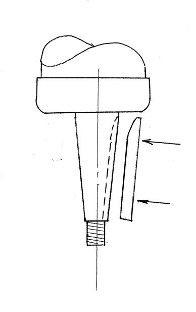

I think you've got some typos above...CrandallJ wrote: ↑Mon Mar 20, 2023 12:25 pmThe T is a 1925 coupe. I have the tapered key facing not facing out towards outside of shaft. I have taken pictures with my iPhone and attached the pictures. Format issue. Appreciate all the replies and if someone has recommendations on who to attach photos will be greatly appreciated.
Is this how you're orienting and inserting your key?

Re: Rear axle keyway
My two cents:
If the inner end of the keyway slot in the axle is covered by the end of the seal, then the seal isn't installed far enough and the slot will eventually chew up the seal material even if you shorten the key.
If I recall, the aluminum seal has an O-ring (or two) that is a tight fit on the axle tube. It can be difficult to get that O-ring to slide all the way over the axle tube, especially if it isn't lubed beforehand.
If you have installed the neoprene inner grease seals and they are stopping the bearing sleeves from going in far enough to be flush with the ends of the axle tubes, then you need to remove the sleeves and grind the inner ends (the ends that fit against the inner seals) until the outer ends of the sleeves are flush with the ends of the axle tubes.
If the axle keyway slot clears the seal, then the correct key should fit without modification, but if it didn't I wouldn't hesitate to shorten the outer, square end of the key if it sticks out too far.
BTW, those tiny welch plugs are a pain in the butt.
