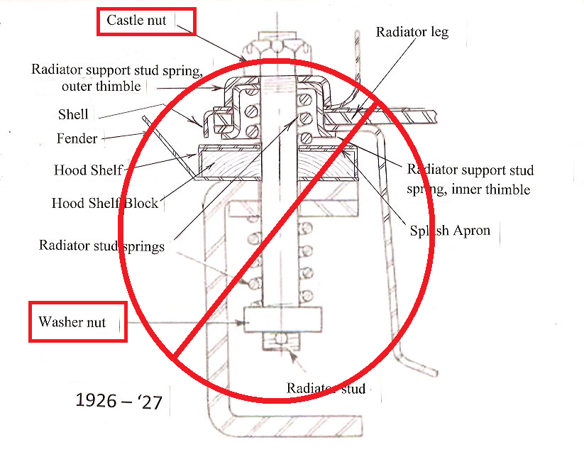

In the drawing, the radiator apron is shown, but not specifically noted. The apron is shown setting on the bottom flange of the inner thimble. The holes in my apron are not large enough to allow it to fit over the thimble. The holes in my apron are just large enough to fit over the stud. Therefore, the apron sits on the hood shelf. I don't think is a problem. What is your opinions?
Posts: 6669
Re: Radiator Springs
Post by Scott_Conger » Mon Mar 20, 2023 9:28 pm
your part is right, and your planned installation is right
it is your understanding of the drawing that is flawed (I think the drawing while nicely done, could be clearer or more obvious as to how the apron fits). I think your present misconstruing of the drawing is understandable the way it is annotated.

Here is the Vowell Art drawing from the Forum with the apron. Note there is no nut on the bottom of the stud even though it is threaded.
The kit parts match the drawing
Posts: 7074
Post by Allan » Tue Mar 21, 2023 3:54 am
In the top drawing, the panel sitting on the flange of the cup is the lower tank support, not the apron. The apron sits directly on the frame, then the spring, then the cup. The small hole in the apron is 3/8' so it goes over the stud only.

Alan, The piece sitting on the flange of inner thimble is the radiator apron and not the lower tank support. Refer to the attached drawing.
Posts: 6669
Post by Scott_Conger » Tue Mar 21, 2023 12:05 pm
Bruce
With respect, are you even looking at anything that I've posted, Alan's posted, Frank's posted (with excellent drawing which mirrors your exact parts description), Chris and others have posted???
You are describing '26-'27 parts...you've latched onto a faulty drawing at the beginning of your post, and now are posting a drawing which shows how earlier radiators go together (with the apron and shell, both going over the thimble). That is NOT your setup.
Look again at the last drawing that Frank posted. THAT is your car and that drawing matches your parts description.
My goodness, I don't know what else anyone can possibly say to convince you that
you are correct in your plan.

The full apron on a 26-7 T is as wide as the frame. It does not run up the inside as indicated in that drawing.On my 1925 original buckboard, there is a tab bent along the side of the rail, and that tab is jammed in between the frame rail and the fender bracket. This side tab was deleted on the 26-7 models which have a different frame corner bracket, but the top fits in the same manner, a 3/8" hole going over the stud and the apron sitting flat on the frame. Then comes the spring, thimble, radiator, shell, cup, nut and split pin.
Hope it goes well for you.
Posts: 8250
Post by TXGOAT2 » Wed Mar 22, 2023 9:28 am
On my 1927 roadster, the fender sits on the frame, then the hood shelf blocks, hood shelf, apron, spring, etc, as shown in the 3975-76 C assembly drawing above. Everything appears to fit correctly.

Use the 1926- 1927 Radiator Assembly Drawing.
