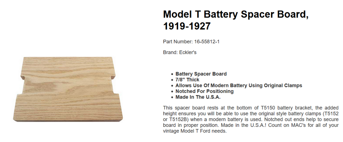

All batteries have standard sizes.
There is one 12 volt battery that very close to those 6 Volt dimensions.
What most people don't realize is that 12 volt battery has six more cell walls and three more cell partitions.
Tha situation results in far fewer internal plates that make the electricity.
That situation also results in the battery appearing to be going bad a lot faster then it should when cranking the engine.
So, either the engine stats right away or you look for another problem and blame the battery.
That wood piece is sold by several vendors.
It is a piece the same size as the battery with a notch cut in each end for the metal strap that holds the battery.

- Posts: 6395
Re: New Battery
Here is the "shim" for the underside. Also available from suppliers (maybe) . You should also shim it so it doesn't slide, just a boarder on the bottom board. The hold downs are just to hold the battery down. Thickness is what you need.
