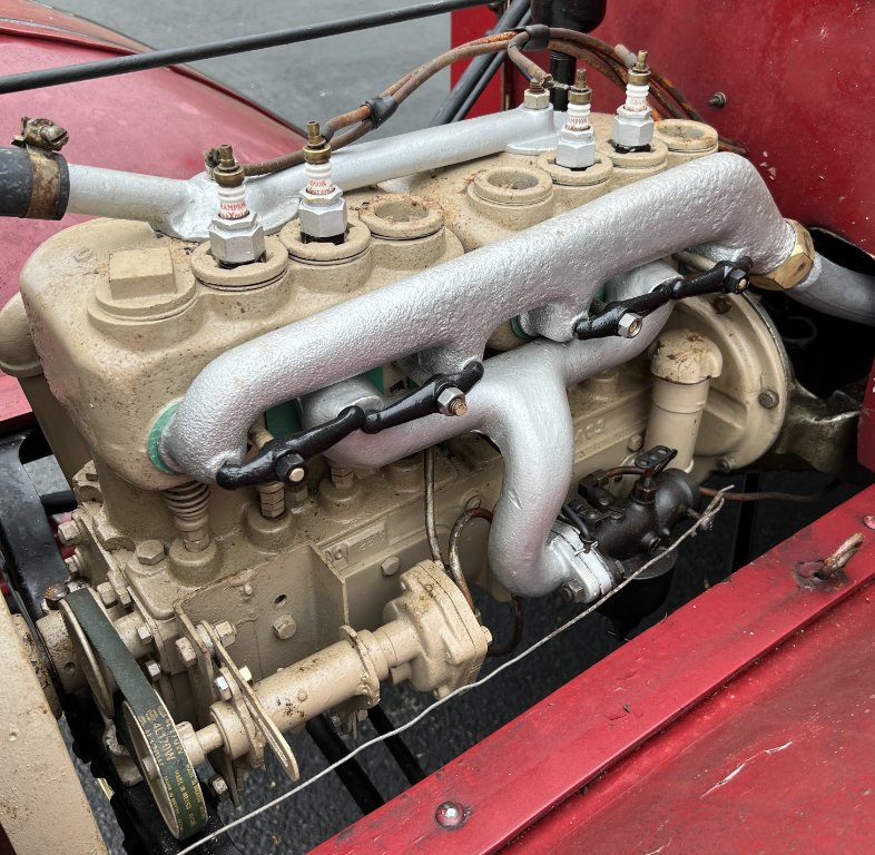

Post by Neversurrender » Thu Mar 23, 2023 7:55 am

I like the layout of those engines. The oil pump is a later replacement as is the breather on the inspection plate. I'll bet the Model T carburetor works well on it.
Thanks again for sharing the pictures.

I think the pump is an oil pump, reminds me of a Stove Bolt pump. Dave in Bellingham

Thank you for the photo. If it’s the original motor, and if I’m seeing it correctly (26XX), then I think it’s a late June early July 1908 car (Trent Boggess ledger database).
Is that by chance an oil pump? It looks like the original McCord oiler isn’t on the car (it would drive from the camshaft end to the right side of the motor, the same shaft currently driving the device on it now.
Hope to hear more on the EFR site if you come over. We have several members and participants with NRS who may be able to help with any questions or parts.

It does appear that the original McCord mechanical oiler has been replaced with a more modern oil pump on this Model S roadster. If I am seeing it correctly, the modern oil pump is drawing oil from the bottom of the crankcase and pumping oil to the right hand side of the motor. Originally, oil from a mechanical oiler was fed to three location on the motor and transmission. One feed went to the front main bearing, a second feed went directly to the side of the crankcase, and the third feed went all the way back to the rear of the transmission frame.
One wonders what the right side of the engine looks like and where does the oil line go to. An additional question would be if there is a supplemental oil tank somewhere? Model NRS engines had a total loss oil system. Oil escaped from the main bearings, past the piston rings, out around the push rods, and from the rear transmission bearing. The lost oil had to be continuously replaced.
The oiling system differed between Model N cars and the Model R and S cars. The Model N used a pressure fed oiler. Gases from the exhaust manifold pressurized the oil tank forcing oil to drip into two lines, one back to the crankcase and the other to the rear transmission bearing. The quantity of oil flowing was adjusted through needle valves on the side of the tank. The operator measured the oil flowing through the two lines by counting the drops per minute through two sight glasses on the oiler.
The oil tank on the pressure fed oiler had to be replenished regularly.
The Model R and S cars used a more reliable mechanical oiler. This oiler was powered by a steel spring belt, that looked like a screen door spring, from a pulley at the front of the camshaft. Integral with the mechanical oiler was the supplemental oil reservoir. Oil was fed through three lines, as mentioned before, to the front bearing, the crankcase, and the rear transmission bearing. The flow of oil going to each line could be adjusted individually.
As in the Model N, the oil in the mechanical oiler had to be replenished regularly.
You might want to ask where does all the oil on a NRS car go? The answer is everywhere! Oil leaks flown the side of the crankcase to a drip pan. The operative word there is drip. Oil from the rear bearing leaks onto the exposed timing gears. Oil from the rear transmission bearing leaks down the driveshaft tube towards the rear of the car. Oil leaking from the motor is joined by semi-fluid grease leaking from the transmission, which results in oil all over the underside of the car. It is not uncommon for an NRS car owner to have to spend an hour of cleaning and maintenance for every hour of run time of the car.

Antique stationary engine people might have some early McCord oilers.
