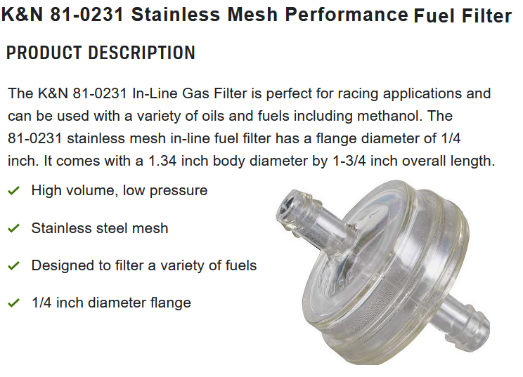

"I put a temporary fuel filter in the line. It is a riding mower filter so it is a little higher flow than some."
Likely the issue. There are several riding mower filters (some looking alike) but rated for different HP engines.
These have a simple round mesh much like what's in the sediment bulb but a finer mesh and in some cases requiring a fuel pump. Any of the cylinder types are likely requiring a fuel pump
As an example of similar ones --
Then there's this - but what is "low pressure"?Atmospheric with gravity assist?

I would see if the tank needs cleaned, and if it is reasonabley free of debris, a mirror can be used on a sunny day to look into the tank for evidence of rusting, dirt, or fine debris suspended in the fuel. Do not use a flashlight! Have the tank full, and shake the car to stir up fine particles, then use the mirror to reflect sunlight into the tank. If the tank is reasonably clean, the stock type screen and bowl will be entirely sufficient.
Physically small filters have a very limited capacity to collect debris or moisture without becoming restricted or outright plugged. Any added filter will add restriction.
An added filter is not necessary, nor is it a good idea on a gravity feed system, and it's an especially bad idea on a Model T with an under the seat gas tank.
Be sure that the vent in your gas cap is not plugged or restricted.
A gas tank that has water or fine rust or any other debris in it will cause you problems no matter what kind of filter or filters you use. With that said, the best filter for a dirty system is the one Ford originally used, which has a bowl to collect sediment and moisture.
The next best choice would be a tractor-type filter with a deep glass bowl, and it should be mounted in the same location as the original Ford filter/bowl unit.
A stock type filter that needs frequent cleaning indicates that the fuel tank needs cleaning.
