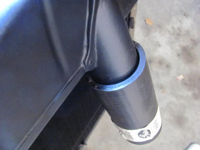

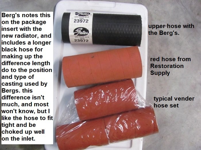

Pictures help to understand (found some). I also have a Berg. I just tried to fit an older red hose to it and it fit nicely. I then tried a recent repro that was a darker red and it felt a bit loose on the radiator but not the water neck. Need to find the black hose that came with the radiator.
This problem was discussed in a few older discussions, but only length & fitment were at issue
https://www.mtfca.com/discus/messages/1 ... 1283611652
.In the photo where the upper clamp is, that's about 1/2" past the end of the outlet
berg & upper outlet.png (430.89 KiB) Viewed 3504 times
https://www.mtfca.com/discus/messages/7 ... 1509768274
Restoration supply https://restorationstuff.com/

Berg's is a very well built radiator, for me only real thing is it isn't Ford design tanks, and he uses an available , but good, long neck casting for the upper inlet. That part is different, and have experienced hose connections to be more difficult because that neck is smaller dia. than the Ford design.
Gary told me the avail casting is all he could get, the neck is narrow, so by using the longer hose, you slide it up to gain more contact of the neck, as the end portion of the casting has a bead, that bead is small diameter. My choice was to use modern worm tooth radiator clamp, placed up high.

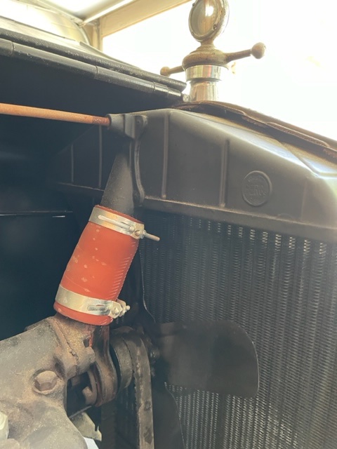

Post by George Mills » Mon Mar 27, 2023 12:35 pm
Dave,
Last one I got from Gery went on a 26-27. I was able to use normal red hose but do recall a fight, where the solution was to slide the red hose up high on the neck, guide the lower on the head outlet as radiator was installed and then wiggle down and clamp all up…no leaks, no rtv. Pictures follow

Post by Dave Young » Mon Mar 27, 2023 9:43 pm
No leaks, all good!
