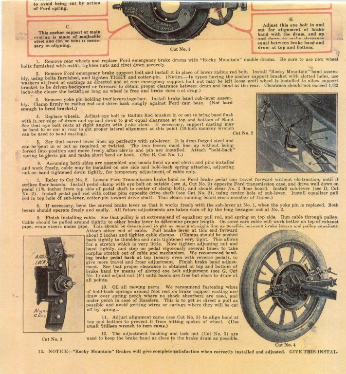

I asked about Rockies and reverse at last night's club meeting. I gather that the problem is with the modern version, not the originals.
Posts: 2531
Last Name: Strange
Location: Hillsboro, MO
Re: rocky mountain brakes
Post by CudaMan » Fri Mar 31, 2023 2:39 pm
The different braking power in reverse vs. forward is caused by the location of the brake band anchor point. The Rockies currently available from the vendors have the anchor point near one end to maximize the self-energizing effect while going forward. The original and earlier reproduction Rockies had the anchor point in the middle of the band, giving the same self-energizing power in forward and reverse.

Post by Original Smith » Sat Apr 01, 2023 11:32 am
I have those instructions too. I believe there is a page 2 for them also, but haven't seen a page 2. You might notice the cams on the bands for adjusting the alignment of the band. The first series brakes did not have this, and would have to be added to be 100% correct. The first series I'm referring to was made before the current offering, and as I mentioned Jack was not mechanically inclined, and probably didn't know what they were for!
