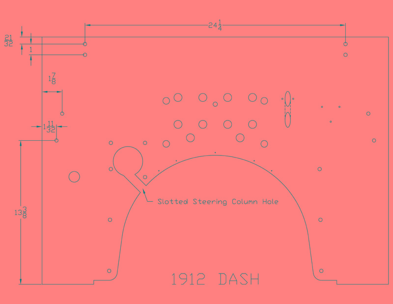

Finally found some of the information I was looking for on an image in another thread.
http://www.mtfca.com/discus/messages/82 ... 1543334612
It looks like it was drawn by John Regan so I am confident it is correct.
It confirms what I suspected. The brackets are in the wrong place on my current dash.
The image is not very clear, due to the low resolution, but it looks like it is 24 1/4" between the sets of holes. The top hole looks to be 21/32" from the top edge of the firewall and the lower hole is 1" below that. I suspect these are 9/32" holes like the side lamp bracket holes. Someone can correct me if I am wrong (and please do!).
These dimensions match the original October of 1914 firewall that I have.
Just a note, This drawing does not show the second mixture rod hole that made the dash reversible.
Still looking for answers to my other two questions on the first post.
Also, does anyone know when the hole for the horn showed up in the dash (shown in this drawing)? Going from memory (dangerous), I think my car was built right before that. My horn is on the outside, but if it was drilled for it at this point in time, I would like to make it right.

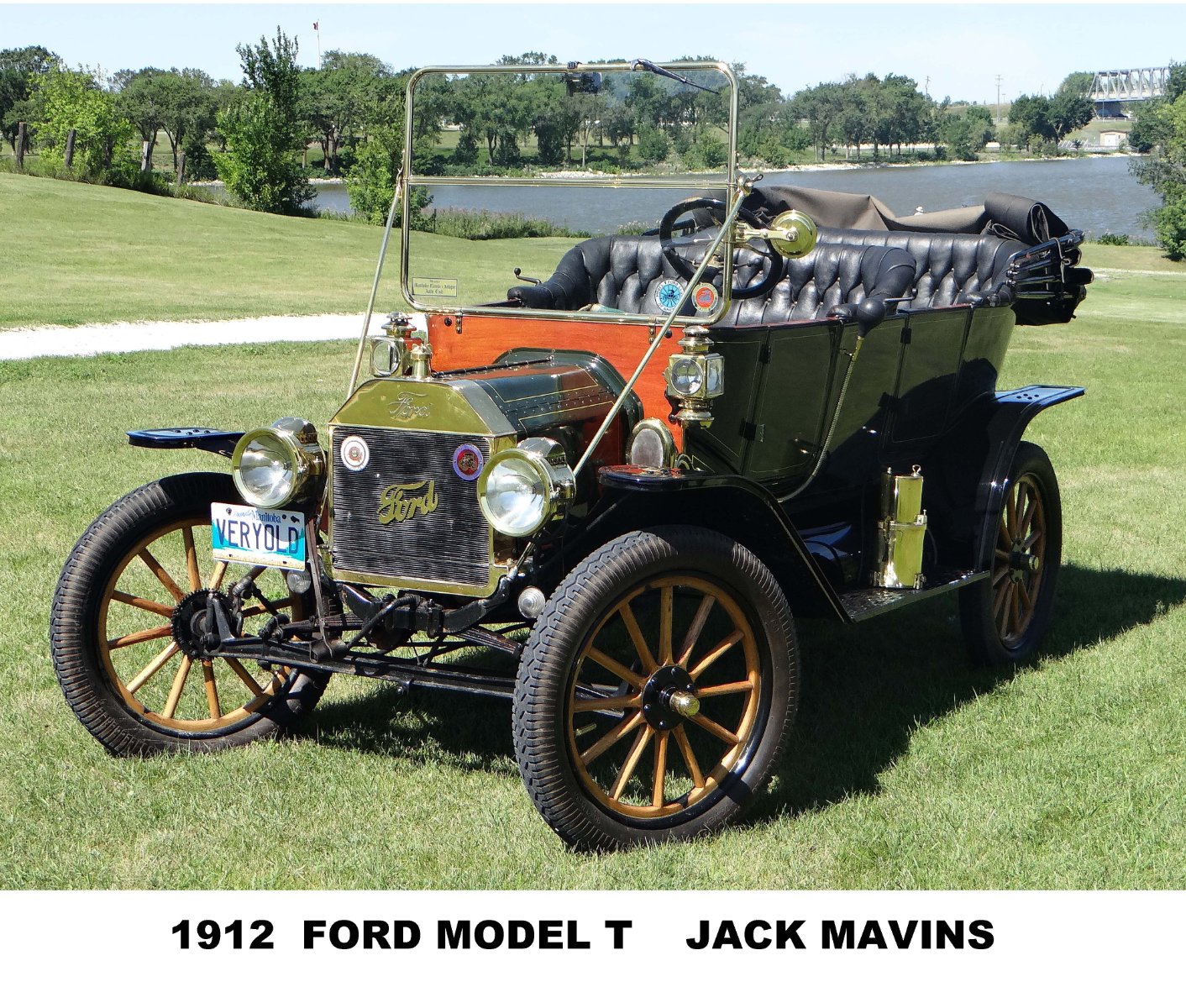

if you enlarge you can see the clamps cheers Colin

Cheers Colin

Post by Colin Mavins » Sat May 11, 2019 3:36 pm
here is a close up the brass trim is original as are the brackets Cheers Colin
