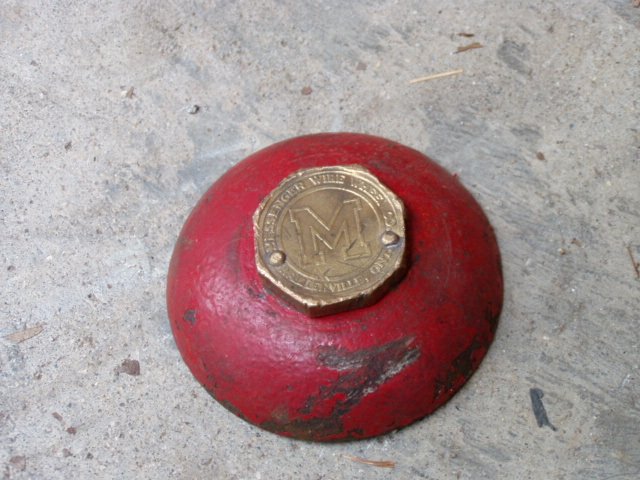

Gentlemen of the Messenger Wire Wheel Clan - it appears that I have joined this kinship as of yesterday for I have a partial set of Messenger wheels now. I shall begin my quest for 2 front hubs and 2-3 good wheels. ( I must like the challenge of trying to complete a set of unusual wheels I suppose. I was successful in completing a set of Mott demountables a few years ago , so why not Messenger also ? ) I too would be interested in a set of wheel nuts/caps .

Can the hub cap on the Messengers be made of brass, such as in a casting? or is it some type of hardened steel that acts as a lock to keep the wheels securely on the hub?
In other words, is the hubcap just decorative, to keep water and mud out of the hub, or is it a structural part of the wheel assembly?
If it is just brass, and someone is willing to supply one to use as a sample to make a pattern, I would be willing to take a stab at it. The part supplied as a pattern would NOT be used to produce anything, it would only be used as a measurement example for the production of a pattern to make some castings, and returned after measuring and photographing.

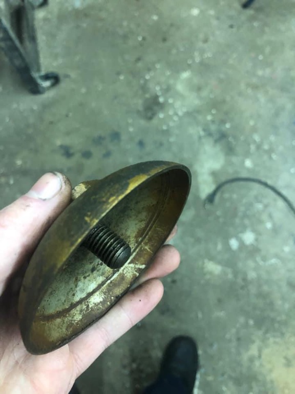

Post by Tracer » Sat Mar 25, 2023 12:12 am
I have all this information. Let me put it together and I’ll put a post up on here with photos, measurements etc. I would also be interested in a set as well.
They are purely decorative hubcaps

Post by Tracer » Sat Mar 25, 2023 12:58 am
The first 4 pictures
Not my measurements but kindly provided

Post by Tracer » Sat Mar 25, 2023 12:59 am
Last photos for now

The measurements are helpful, but not enough to generate a pattern from. I would need a sample to examine to tease out the specifics of how the pattern will have to be made. Or if someone has a detailed drawing giving such information as the thickness of the hubcap, whether the thickness varies or not, the radius of the outside of the cap, versus the inside of the cap, radius on the edge of the hubcap, etc. etc.
A sample would also allow an accurate photo to be made, for the purpose of generating a master for the engraving on the hubcap medallion.

Andrew
regarding your dimensions: the 1/2-14 you show was never a standard of any kind at any time for straight threads (for tapered pipe threads, it is standard)...are you sure it isn't 1/2-13?

Post by Tracer » Thu Mar 30, 2023 1:44 pm
Hi Scott
These were kindly provided to us so not sure really
I have never seen a hubcap in real life. I will check mine before making the caps I guess now

Post by OilyBill » Fri Mar 31, 2023 11:37 pm
1/2"-12 threads and 1/2"-13 threads used to be commonly available.
The standard thread now is 1/2"-13, but I have a tap and die set for 1/2"-12 and I see them advertised occasionally on Ebay and other sales sites. It became obsolete in the late teens, (probably during wartime production in WWI it was dropped as a specification), although "Machinery Handbook" still lists it as an available thread size, and shows the standards required for production use.
(Similar situation to the Harley 1/4"-24 thread, which has been referred to as the "Harley Bastard Thread" but is really not. Harley picked it because they wanted a slightly coarser thread for use in their aluminum castings. But actually this thread was very popular in early automobiles that used aluminum castings as well, so it was not just used by Harley.)
If you look at an older copy of "Machinery Handbook" you will be surprised to see that there are six or seven (sometimes as many as TEN!) different thread pitches available in various sizes. Current thread sizes are the most common uses, but I have seen MANY early automobiles that used variations that are pretty rarely found, but were picked by the factory engineers for some pet reason. I have found that it is VERY WISE to closely examine any mystery thread, and determine EXACTLY what the true pitch number is, before you casually run a tap through a hole to clean it up. (This is not so common on Early Fords, as nearly all the screw threads were selected based on them being normal industrial standards at the time. However, it is important when dealing with accessories and odd performance items that did not come from Ford. Sometimes small companies used whatever thread size they might have had tooling for, rather than buying a standard threaded part, so you can get an occasional surprise. I have found both 8-36 threads, and 10-36 threads several times on early machinery.
It is true that standard thread sizes were not OFFICIAL before the 1910-1914 period, HOWEVER, the 60 degree screw thread in today's standard sizes was well established during industrial production for the Civil War in the 1860's, and was the fore-runner of todays SAE specs.
