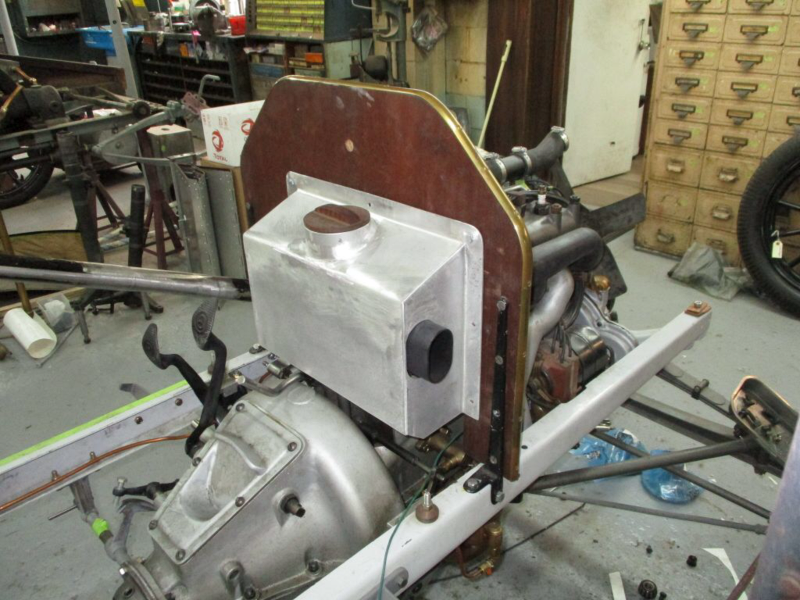

The other drawing may be the surround for the number four cylinder exhaust pipe if it ports from the "dash tank" on the opposite side of the yellow dot.
Note how the draftsman calls it "Gas Tank" one place and "Dash-Tank" another. I feel he is talking about the can behind the dash in the photo below, yellow dot.
Check out how the hole has a vertical elongation. Probably for torsional movement of the engine. 8-)
I am assuming the #4 comes out of the "Dash tank". :?
If so, there may have been a wood piece behind a 4 inch hole in the side of the "dashtank" with the 4-7/8" diameter surround to mount it with the four wood screws. The elongated "hole" would allow an exhaust pipe (Nozzle) of < 2-1/4" diameter, say 2" maybe?

That makes sense. It might also explain the vertical flat portion of the drawing (left side). I have side pipe drawings for some of the racers, I'll look for them and post a few.
The first folks to begin this project (I've read that this engine may have been around since the mid-1950's) decided all four cylinders exhaust out the right side of the false tank. I think sometime in the future I may make just the #4 cylinder exhaust out the false tank, and have straight pipes our the side of the hood for the other three.

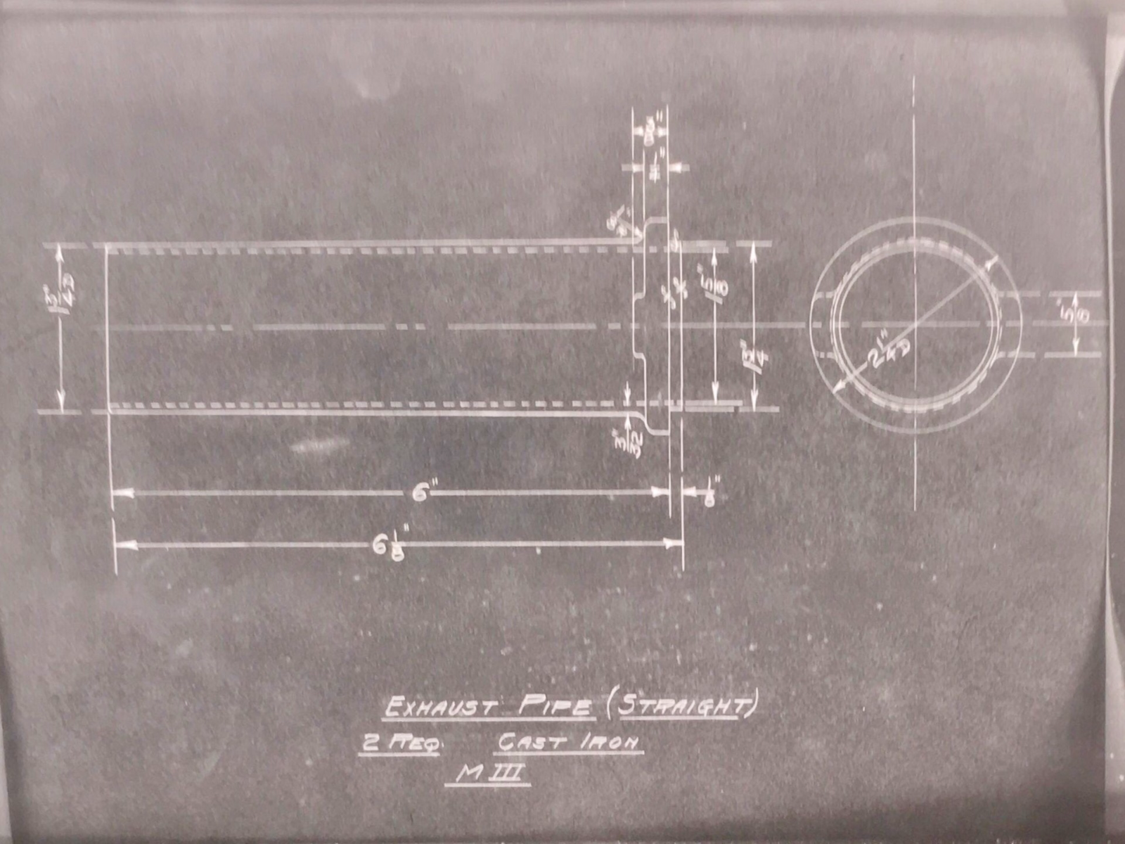

These are the exhaust pipe drawings for our motor (M-III):
The drawing of the "dashtank" is also listed as "M-III" (the photo above was enlarged and M-III not shown);
If this is the side flange for the #4 exhaust pipe, that would help fill in the blanks about how this motor was exhausted. Unfortunatley, the way the drawing is listed doesn't help.

I didn't notice the elongated port on your can before. :o
We had a bad hail storm last night and I just came back in.
I was going to add to the earlier post that if you hadn't cut the hole in the Dash can you could position it with the surround. If you already went by the Ford drawing of the Dash can, I surmise that Frank Kulick penciled in a "we should have made the surround position on the Dash Can up here a little higher" line after he tried to put it on. :lol:
You should be able to twist the two Curved exhaust pipes whichever way buttons it up right for you. Also, if you wish to move any of the #1, #2 and #3 ports more toward the front I suggest using Curved pipes to do it. The call is for a 1/2" reverse curve but you could go more. Who's counting? :)
Think about the magneto bump and the drive housing/oil breather bump. There are a couple of photos we could discuss here. They are positioned relative to the exhaust ports.
I guess the cap in the top is to access the #4 plug? Is this my Lucky Day?

Escutcheon plate, :shock: had to look that one up too Rob, but that's what i meant in my comment on your other thread, the dimensions of the hole in the drawing just seem right for the exhaustpipe on your racer, too much of a coincidence...
The names on the drawing ('dashtank' and 'nozzle') may be just to keep the true purpose hidden for curious eyes ;)

An afterthought; as the whole idea behind the false 'dashtank' was clearly to disguise the fact that the racer had a much bigger than stock engine, It would be obvious that the engine was bigger if three pipes would come out the hood and the fourth out of the 'tank'
It still strikes me as a odd idea though to have (as a result) a whopping large exhaust pipe jutting out of a 'dashtank', so much for "concealing" the bigger engine.
I think the whole setup was more to fool audiences into believing they witnessed a stock Ford win, than to fool officials or the race promoters ;)
