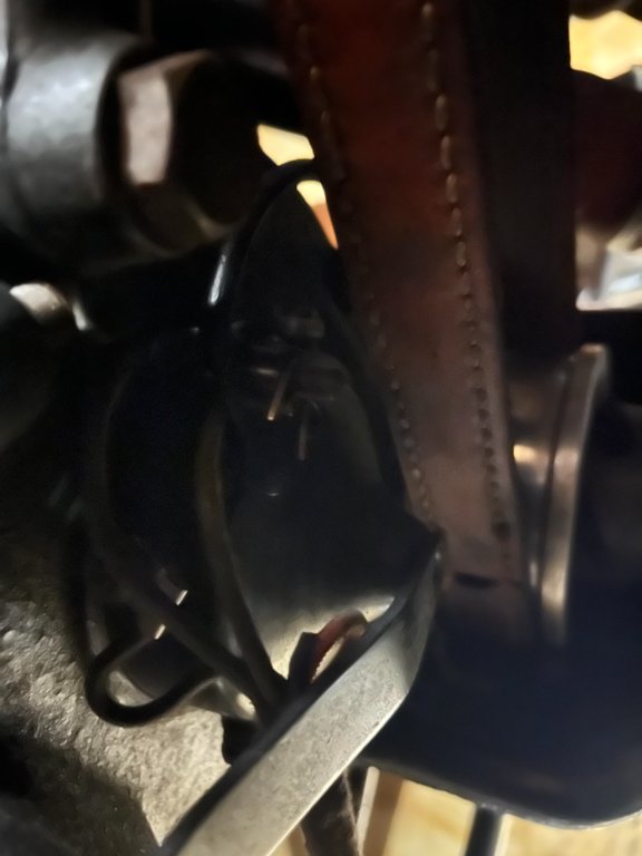

I am open to suggestions. Below is a photo of what is on my 24 Coupe and I have no clue as to what kind of timer it is.
Ron
- Posts: 7344
Re: Waking up a Sleepy T
Too dark. I can't tell what it is. If it's a roller timer (Ford, Tiger, others) the common problems are: 1 weak or broken spring; 2 roller "wallered out" on its little axle, causing it to wobble; 3 the track worn unevenly, causing the roller to bounce and skip.

If anything I have to much travel. When you pull the spark lever all the way down the timer hits the leather belt.
- Posts: 6596
You do not have too much travel...you have too long of a fan belt, and to adjust it correctly, the fan has to go to high and swing toward the passenger (timer) side to accommodate the extra length. Put on the correct belt and your timer fouling on the belt will go away.
At 30+ MPH you will need all that travel which is now crashing into the belt.

Your timer requires constant maintenance. I believe every 300 miles. A drop of oil before each run. Again, the service manual has the details.
Get used to removing the unit & cleaning. The contact ring must be round & smooth or at higher speeds the roller will jump causing progressively poorer running. The roller's pin must be tight. Minimum roller slop. The spring must have enough tension to make good, consistent contact.
Is the motor timed correctly? Look @ the roller/brush mount. Under the 3/4" nut, there should be a pin & retaining washer. That pin correctly times it to the cam. It need not be there. Clamping the nut down will hold the brush without the pin. If missing the pin & not lined up with the pin hole, timing will be off.
Do you have full travel with the advance lever & is it pinned tight? Answered yes, too much.
Now confirm correct firing time. Turn the motor to where the pulley pin is 15 degrees past horizontal. About 3:30 & 9:30.
Disconnect the timer rod. Turn the timer counter clockwise some. Turn on the battery ignition. Rotate the timer clockwise until a coil starts buzzing.
Turn off ign. With the spark lever all the way up, the timer rod should be in position to line up with the timer hole. If not, bend the rod so it does line up.
Correct timing position may gain some belt clearance. I suspect you are set over retard. Explains excessive carbon & not getting enough advance until you hit the belt.
