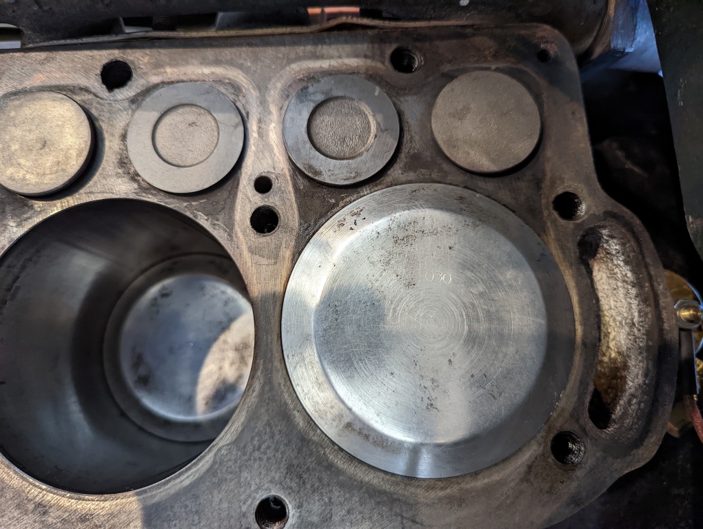

Re: Sound
Have you looked very carefully for any evidence of piston scuffing or scoring? Check both the upper and lower bores. The lower edge of the piston skirt in the second picture looks odd. Is that oil?

- Posts: 7909
Re: Sound
The pistons appear to be a good tight fit in the bores, which is good. However, the overheating incident last August could have led to some scuffing or light scoring of one or more pistons, which could cause a sound like that.
A Z head would certainly raise compression, but it's still very low for an engine running on 87 octane gas, and at idle or anywhere near it, the effective compression is very low due to the throttle being nearly closed and thus the intake manifold pressure and actual compression pressure being very low.
From here, it sounds to me like a mechanical issue, probably a minor one.

Re: Sound
Some very light lines, I couldn't catch my fingernail on any of them. Everything felt smooth mostly.

This way you confirm nothing internally will hit. You can install the head gasket.
You can paint the valve pocket/combustion chambers also. Any upset in the paint but no head movement indicates a close situation. Trim tight spots as needed.
My experience with past Z heads is the combustion chambers vary wildly.
