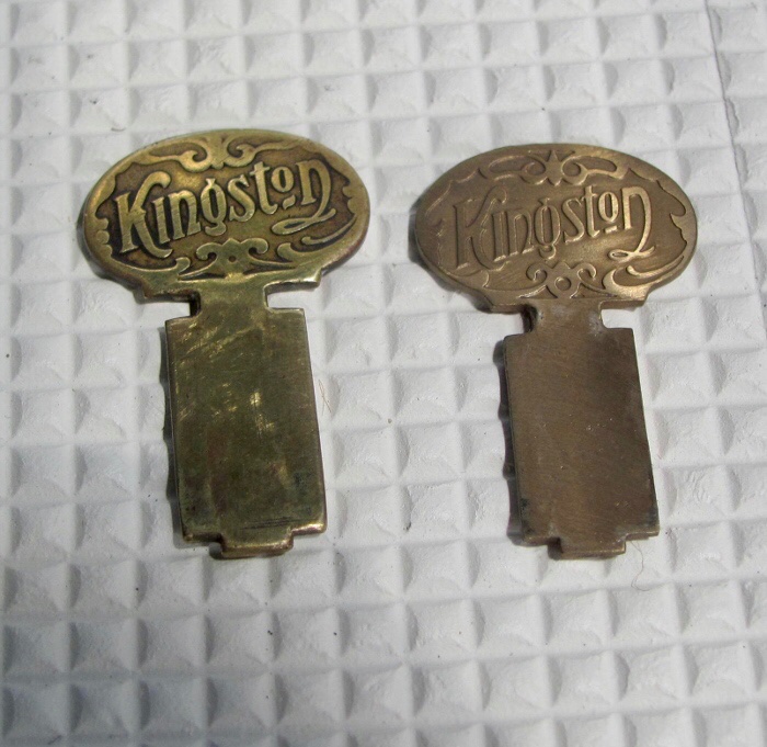

I have been asked of the difference between original and reproduction keys. The one on the left is an original, the one on the right is reproduction. From an earlier post from a few years past.
https://www.mtfca.com/discus/messages/5 ... 1469642342
