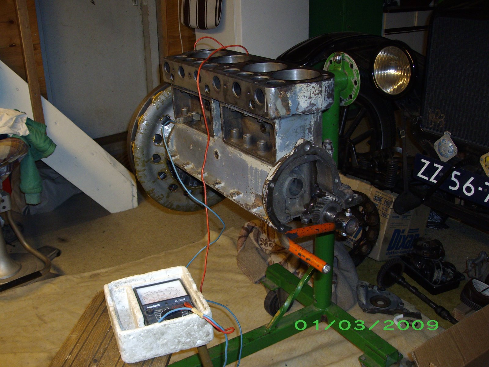

What voltage should you get with an analog A/C voltmeter at the mag pickup point when cranking? I’m looking at a non running car that has sat for years and wondering if mag is functional. There maybe other simple test, and open for ideas. Thanks

Mike ; As soon as I mounted the Coilring and Flywheel , I test the mag output . When I crank as fast as I can, then I have about 3 1/2 V AC .
