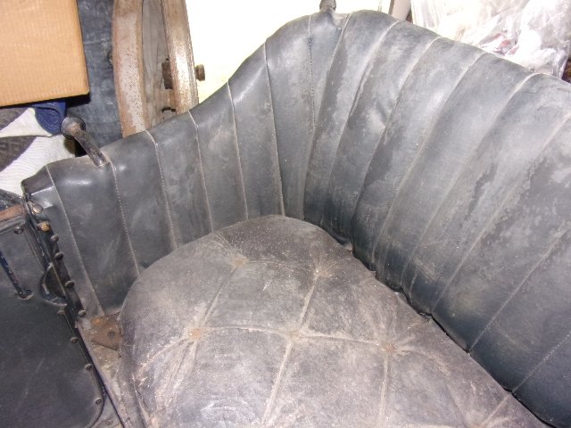

Re: Old Upholstery Question
Photos of the interior. The door and kick panels are actually pretty decent and very savable I think. The seat back is also fairly pliable and not too brittle. The seat back material has pulled away from the body at the very top but just a small bit. The seat cushion is the worst. Like I described above, very dry and brittle with a few holes already showing.
Your seat backs and kick panels are not factory original. They've been replaced. The binding on the kick panels is not correct. The seat backs should have buttons. The end of the armrests should be leather.
One of your cushions is sitting backwards. If the seat back were properly stuffed so the profile was correct, the cushion would probably fit better. If your cushions are leather, they most likely are from an earlier car. I believe that all 1914s had leatherette (artificial leather), not real leather.
You can clean all of the above with a bucket of soap and water. I like to use Murphy's oil soap on leatherette upholstery and kick panels.
Erik is correct, that has been replaced probably many years ago it looks like.
