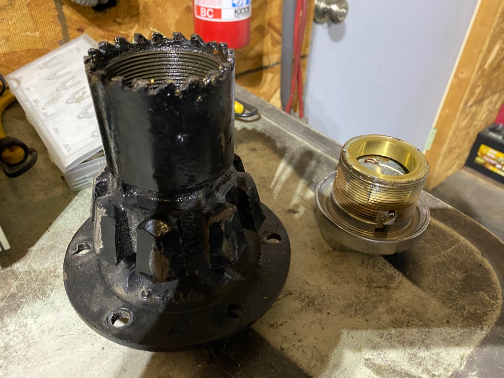

Here is the wheel that gave me problems and the parts of a left thread rear hub and hub nut. You can see the locking mechanism for the hub but.

I can also see that the hub nut has been bored out and slit in several places thru the thread. Then a ring inserted and soldered into place to reinforce what was no doubt a collapsed hub nut with bad threads. Not to say that this repair was not sufficient, but very likely the hub has similar wear and/or distortion of the internal thread.
I would start by measuring and comparing all your hub nut thread sizes with thread wires. Overtightened hub nuts can crush and reduce their diameter.
Also measure the diameter of your hubs on the outside of the threaded barrel section. If the hub nuts are overtightened the hub material can yield and increase it’s diameter. This effectively wears out the thread in the hub

That hub and nut are spare parts, not on the car. It seems these parts are not very common and there is little knowledge of their use. Perhaps they are worn out. I agree with you Kevin, that they can only be tighten so much. Another problem is the way the wheels actually fit on the mechanism, they are very difficult to tighten and I see no way to shim them. I may have to switch to Ford wire wheels.
