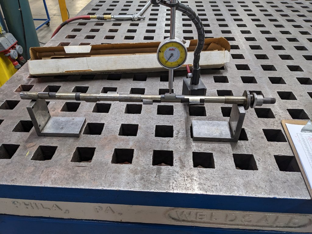

The lobes of the cam in my car measured .215" of cam lift. I have been watching recent cam discussions and planning when and what to purchase. At last night's local club meeting, one member brought two cams for another member who is also searching. He chose the stock, lightly used cam with good dimensions. That left a regrind which I snatched up in a heartbeat. The seller said it was a .250 grind that he purchased many years ago from Langs but never installed. I was thrilled to get it.
I measured the cam this morning and discovered that it was a .280 regrind. Intakes were .283" and exhaust were .287". The little devil on my shoulder said "Use it and keep your mouth shut." But these are my friends, and the seller has been very willing to share his parts stash when I needed it. So, the buyer of the used cam is going to let his engine builder decide which to use. I will get whatever is left and will be a happy buyer.

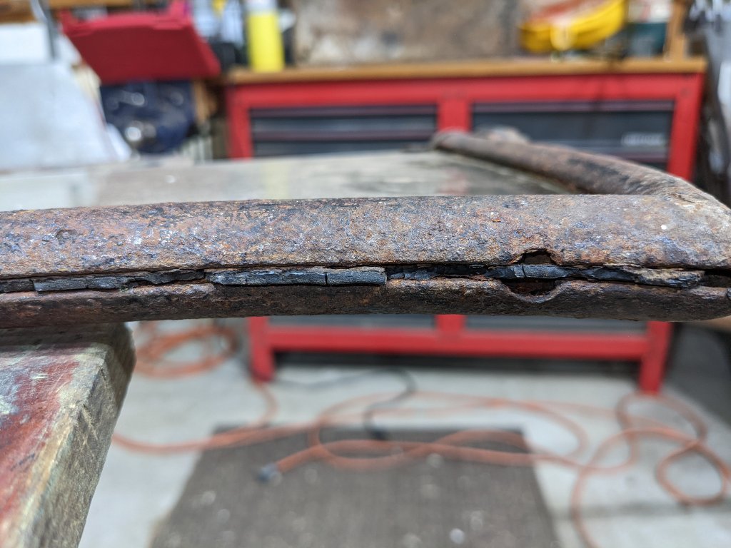

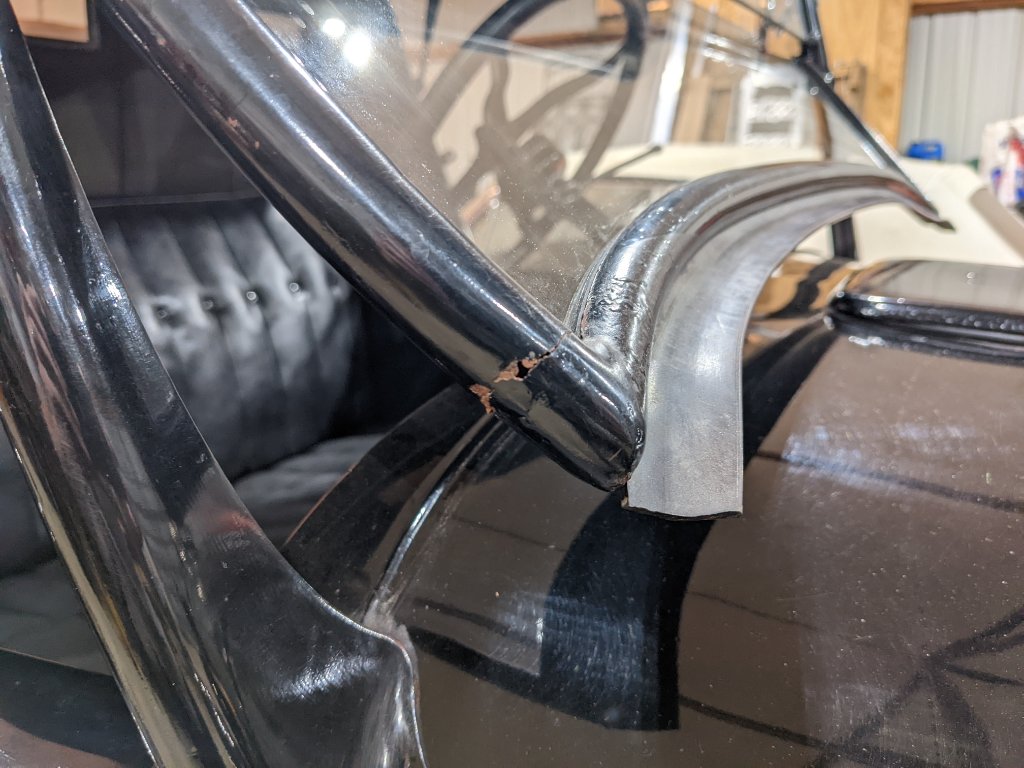

When I had laminated glass installed in my windshield, I discovered that the frame was rusted most of the way through from the inside. The frame cracked.
A friend had this spare frame that was crusty on the outside.
When removing the old seal, I found that inside the channel was clean, shiny metal. It took a lot of work to make the frame look like new. Now it is ready for the glass and new seal.

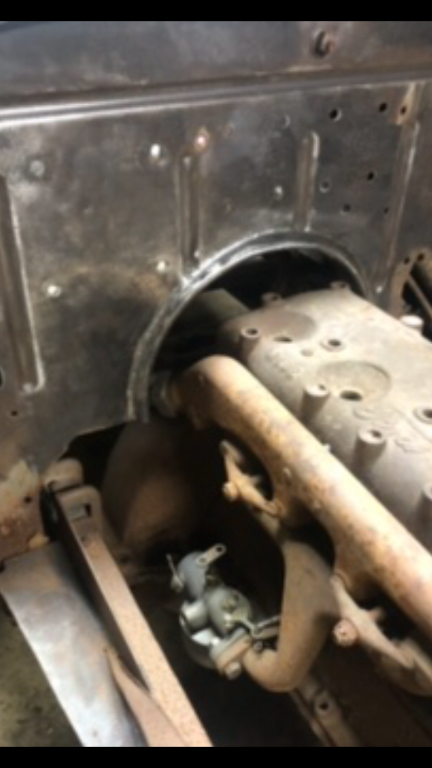

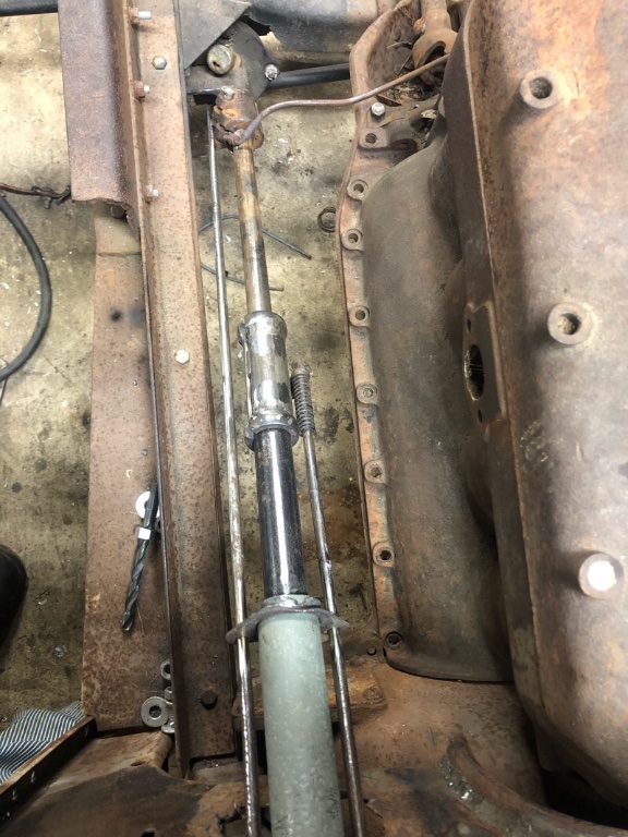

Working on my speedster. I was just about to drill 3 holes for the 22-25 steering column bracket I had clamped to the dash for the T steering column that I already had modified to fit when I thought, I wonder if I could make the Overland column work? So I tried it, then I took it apart, shortened and fitted it. I still have to finish the bottom parts of the spark and gas rods that I extended and make a bracket for the spark rod at the bottom. I welded 1/2 of a Model A brake drum to the firewall so it would look neater. I need to figure out the upper floorboards next.

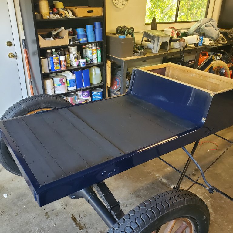

Finally got some paint on the body! I’ve been working on and off on this 23 for twenty years.

Good job Don !! I know what it’s like to be in restoration mode on one antique for nearly two decades. Enjoy this completed chapter

Mike and his engine builder considered the two cam options and they decided to use the stock, lightly used cam. I really wanted the stock cam but now I'm stuck with a .280 regrind. Oh well, I suppose it will be ok.Mark Nunn wrote: ↑Wed May 03, 2023 1:08 pmThe lobes of the cam in my car measured .215" of cam lift. I have been watching recent cam discussions and planning when and what to purchase. At last night's local club meeting, one member brought two cams to choose from for another member who is also searching. He chose the stock, lightly used cam with good dimensions. That left a regrind which I snatched up in a heartbeat. The seller said it was a .250 grind that he purchased many years ago from Langs but never installed. I was thrilled to get it.
I measured the cam this morning and discovered that it was a .280 regrind. Intakes were .283" and exhaust were .287". The little devil on my shoulder said "Use it and keep your mouth shut." But these are my friends, and the seller has been very willing to share his parts stash when I needed it. So I gave the .280 cam to Mike, the buyer of the used cam. He is going to let his engine builder decide which to use. I will get whatever is left and will be a happy buyer.

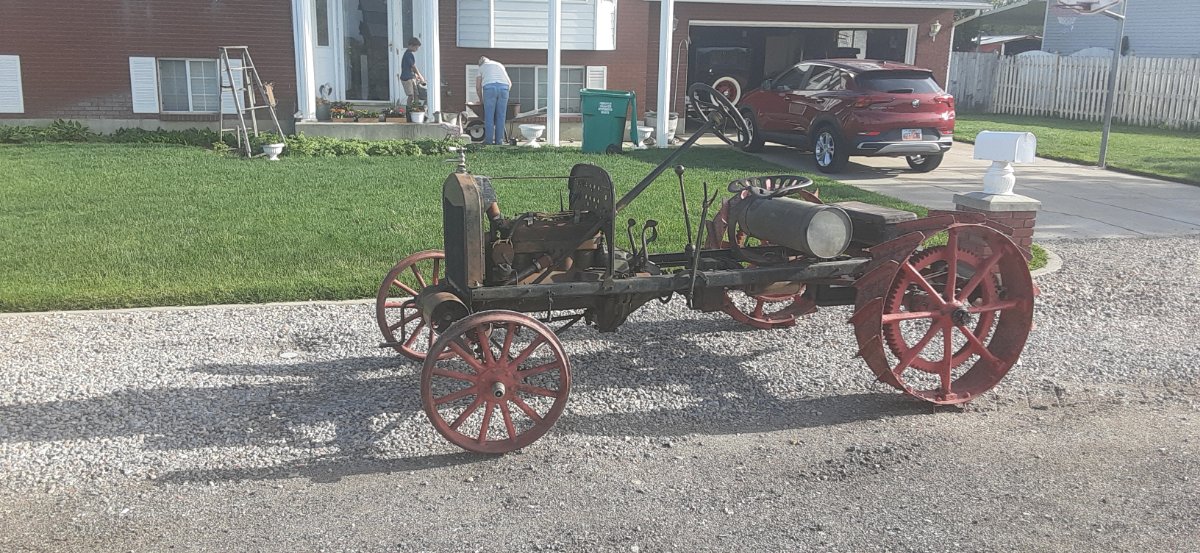

Moved the Shaw out of the garage under it's own power for the first time in many many years.[image][/image]

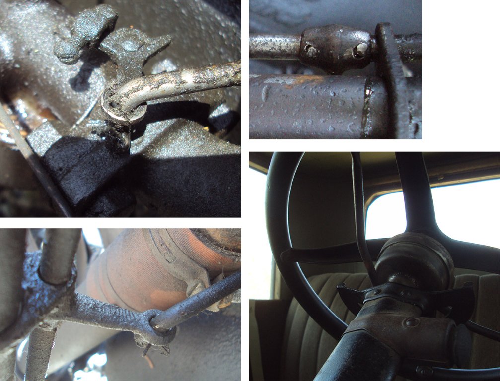

The Coupe acceleration had dwindled to 2 speeds over the Winter. A fast speed and idle with a long swing of the lever in between. Yesterday it was warm enough to investigate the problem. I found 5/8" of linear travel in the carburetor pull rod. The lever pin had worn quite a slot in the throttle rod. I have never seen one this bad. Only one pin was evident, so I drilled a hole for the second one to do the work. A finishing nail had been in place, head and all, showing evidence of a previous fix. As it had worked pretty well when I first started using this steering column, I assume rust had held the lever more solidly until the recent problem. "Good Old Rust".
That took most of the play out of the assembly. In working on the rod arm, I found I could pull up on the throttle arm past the stop on the quadrant and get better access to the other side. I would not have seen the big hole otherwise as the hole's first side was not big at all. There was also some play in the control rod ends in their arm holes.
I decided to take the play out with .010 brass shim stock.
The throttle works nicely now, but lacks an inch of travel to the quadrant stop. I could bend the rod more, but it hits the intake manifold. I will make a shorter rod when I get some 7/32" stock.
The nicer weather lately made this work much more pleasant.

Mark, I still have a ways to go. The plan is to have the bugs worked out by the middle of July. I will get some better shot and start a thread then.

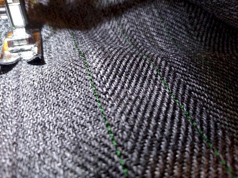

Husband and wife worked on this together. Wife finished sewing up the ends of the seat yesterday.
It sure was difficult on a regular sewing machine. We bought a new bed (mattress and box springs), using the old materials to reupholster the springs. All new wood on both pieces. Took a little while to sew green lines every inch.

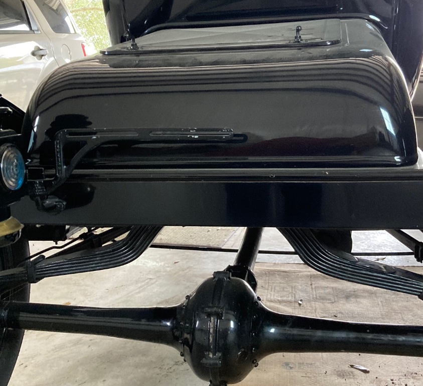

After spending a day cleaning, prepping, and giving a coat of Slip Plate to a nice set of clipped leaf rear springs, I learned about the differences between Model T rear springs and Model A rear springs. Model A springs have a mellower bend profile and they’re 2 1/4” wide versus 2”. Anyone out there need a nice Model A eight leaf rear spring?

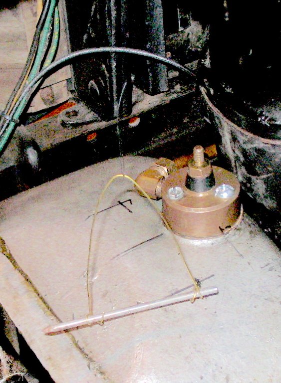

I've been busy with non-T chores, but today I got back to the 1915 runabout with a magnet charge. I've always charged magnets one at a time, out of the car, so today was my first in-car charge.
There seem to be two camps on this. One says use the Fahnestock method for best results. The other says using the compass is a waste of time that makes no difference. There are advocates for both sides who have much more Model T knowledge and experience than I have, so the question for me was: Will it hurt anything to use the compass? My answer was no, so I used the Fahnestock method,
Being me, I have a compass but have no idea where it is. That's one of the many common items not available in local stores, so I made my own. It's not very strong, but for this job it doesn't have to be. Using 36 volts DC I flashed the coil ring with the flywheel in four positions, eight times in each position. The results were good. I started the car on MAG a couple of times. The magneto headlamps were perfectly bright, which means they were almost adequate. This evening Shorty and I went out for the first after-dinner cruise of the season, and the car ran great. I am pleased.

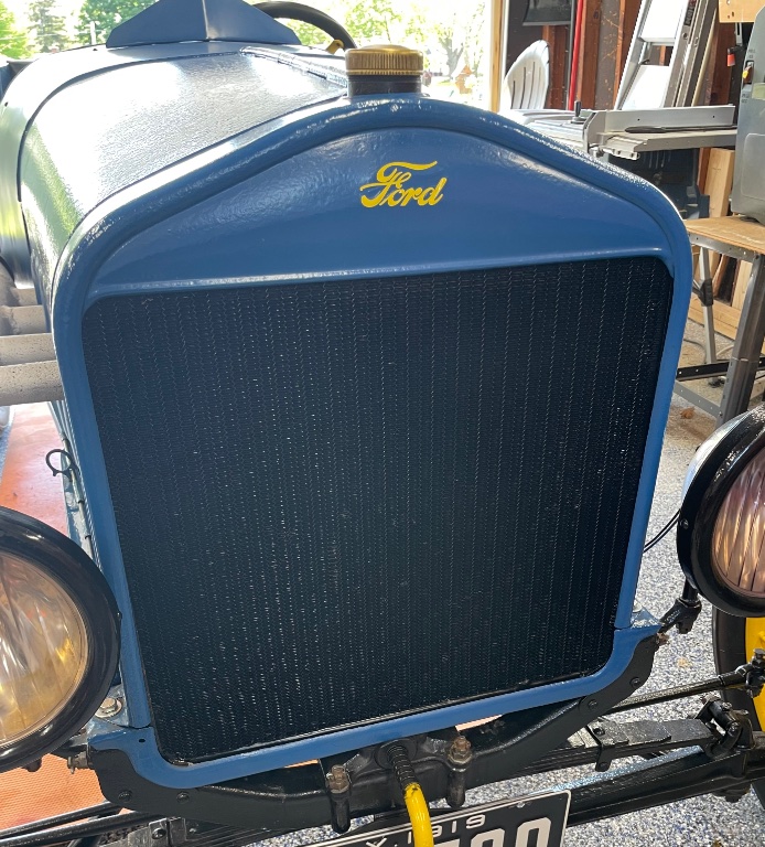

Got my radiator recored at a local shop in Rochester. The old honeycomb core was shot. The shop disassembled the rad, ordered a new V-cell core from a company out west, did other repair work, and reassembled it. Got it installed Thursday and took it for a run. All good! Barring possible damage due to stones and bugs, this thing should be as close to “bulletproof” as it can get.

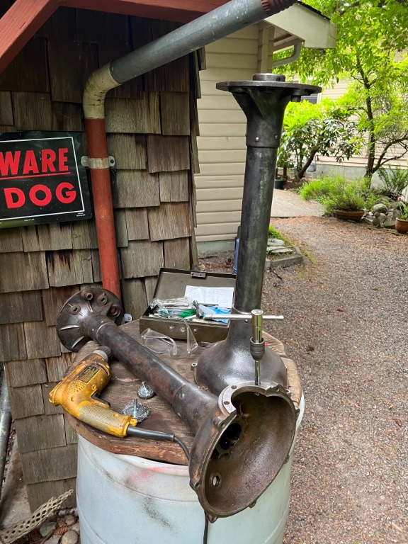

I cleaned a set of rear axle housings for my project car. Liquid wrench didn’t loosen the rusty spring perches nor the other nuts and bolts so I soaked the ends in a bucket of Acetone and ATF mix. I was surprised how easily everything came apart after an overnight soak. Even the outer bearing races came out with little effort. I also got to use the 13/32” - 16 TPI tap I recently got from Dan Hatch through the classifieds.
