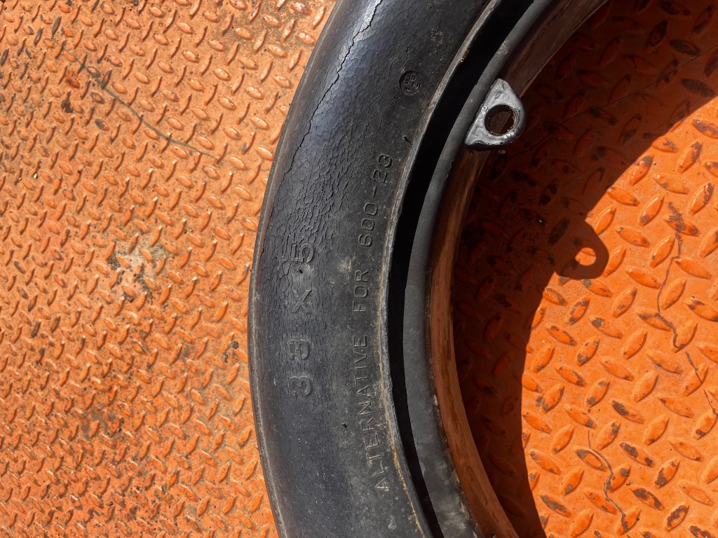

I am getting ready to buy new tires for my TT and I want to know what tires are recommended. It has gum dipped 4 ply Firestone 33x5 Tires. They seem to have been brand new when the car was stored but unfortunately they
Dry rotted. What are some comparable 33x5 tires out there because I don’t believe Firestone produces this tire anymore.

I would reuse the rear tires except the fact that on one of the tires, there is a big crack in the middle of the tread. It is also missing some chunks of rubber in some places. I will take more pictures later.
Thanks for the advice, Jacob Mangold

I believe they are 30x31/2 and yes they do need to be replaced. I will take a closer look. Here is a picture of them.
- Posts: 7393
Re: TT Tires
Insa! I bet it's at least thirty years old.

Jacob, if that is a front wheel photo, it is not a 30 x 3.5" clincher. To my knowledge, there never was a beaded edge Insa tyre. They were 21" straight sided tyres like those in your photo. They did give really good service, and those who still have them are blessed. Someone bought them out and they dissappeared, leaving us with the present crop of junk, Blockley's excliuded.

Well that’s a shame. I just realized that too. What sizes will fit on the rim because the tires are shot.
