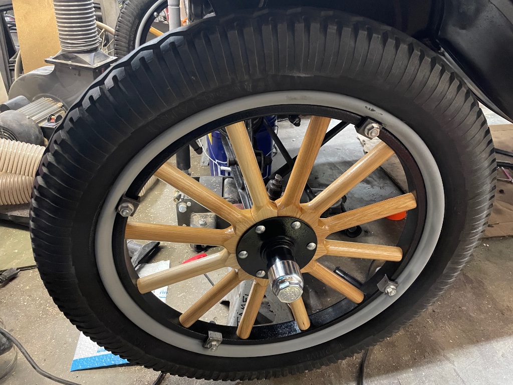

I had a busy winter working on the 22 runabout PU. I moved the body back 3/4 of an inch to the correct location, put new bearings in the front end, new seals an outer bearings in the rear end, along with rebuilding the parking brakes, made brake/running light mounts and installed the lights and brake light switch, installed the engine pans and carb heater, installed a battery horn, installed 5-1 steering guts and rebushed the lower steering bracket, installed Apco steering ends, a new steering arm, and tie rod ball, made a mount for my klaxon horn that goes on the spare tire mount, installed an exhaust whistle and cutout, rebuilt the wheels with matching Kelsey removable clip felloes and rims, installed a speedo drive gear, ordered 2 new tires to make a matching set (in transit), installed a sliding adjuster on my Rocky Mountain brakes, made a fat lady brace, made a new starter cable, repaired the battery bracket, painted the head and exhaust manifold, replaced the freeze plugs, replaced the pins in the hood, made new floorboards and a panel under the seat, installed a steering column brace, and bought all the parts to install a speedometer. The cable and a new head are on order and will go on when they come in.
And today, I drove it for the first time this year. It feels really great. No wheels clicking, no death wobble. Fingers crossed, it should be a good driver. It does need a wash though!

The wheels look pretty good.
