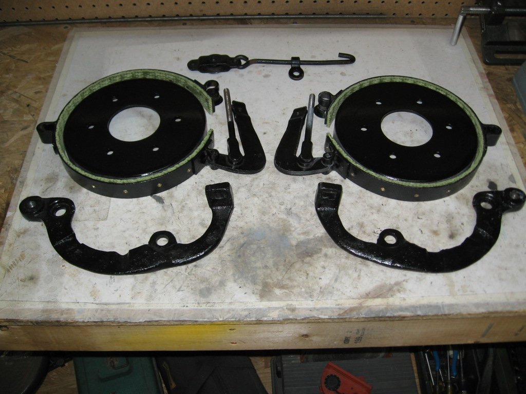

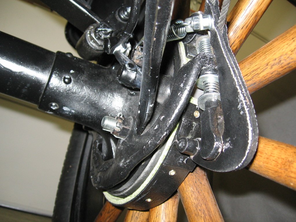

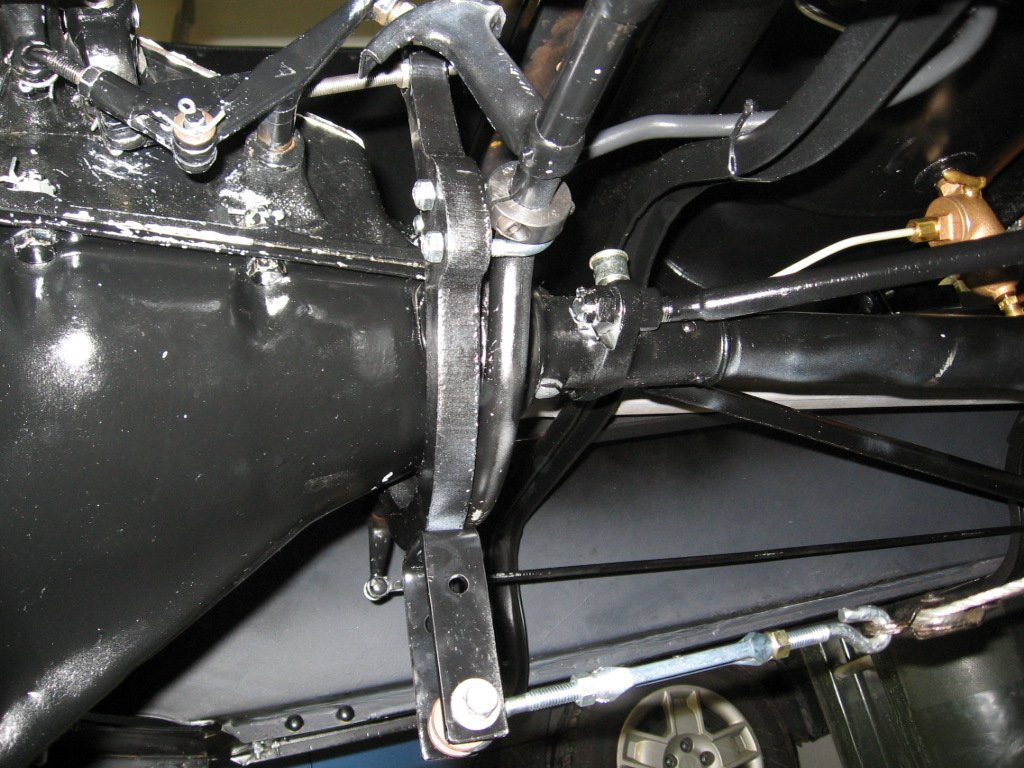

I'm thinking about using a nonmetallic cable for my AC brakes. I have the original set up and I am concerned the fragile appearing equalizer is not up to the stiffness of a steel or even an aluminum cable. The original equalizer is pictued with rust next to Dan Mc Eachern's set up.Thoughts appreciated.
