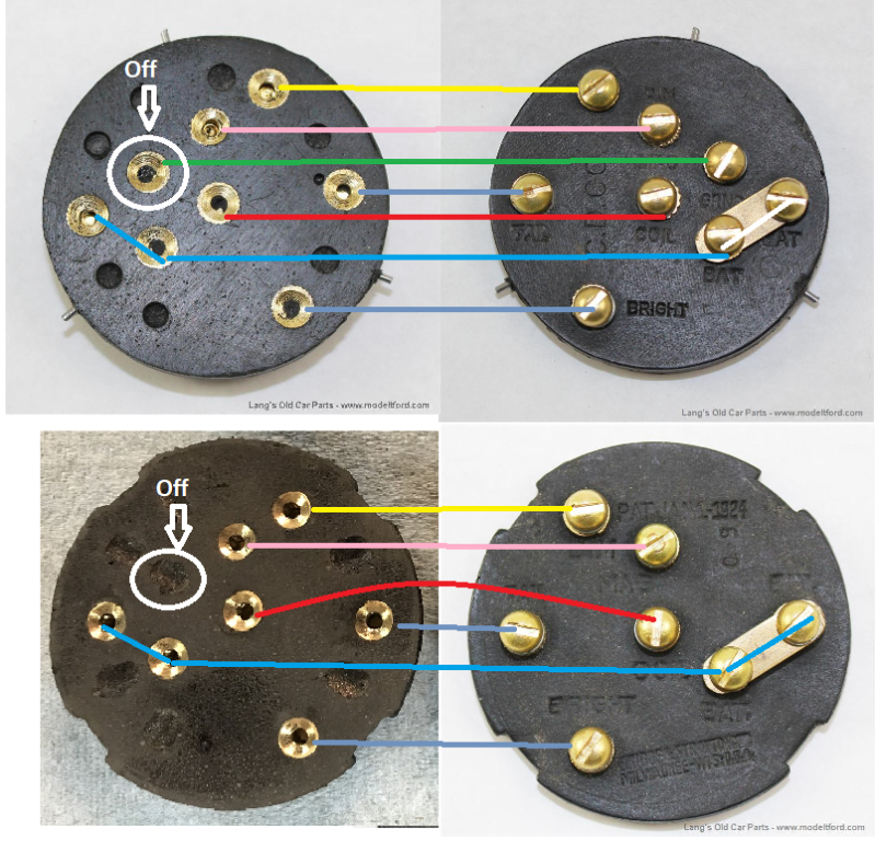

Some switch backing plates had an extra screw. Always hard to answer without some visuals & information. What bulbs are you using filament. LED? Are both double filament.Barteldes wrote: ↑Sun May 14, 2023 11:17 am1924 coupe. fixing problems one at a time with all your help. i have headlights working in low beam but not in high. its pretty darn weak. i took the ignition switch assembly off and examined the wiring and the connections all look good however i dont know anything about which wires should go where. (there is one screw in the back of the switch that has no wire) i guess my question is could it be the easier answer to the problem ( the wrong kind of bulbs)? i hope it would be that easy, i know just enough about electricity to get myself killed.
i have an image but fail to figure out how to add it to this post.![]()
The top switch backing has the "extra" screw. Current repro's don't have this regardless of the backing being a pin or clip type.
The color lines are just to help figure out whats what front to back --
This diagram includes an extra screw backing plate and as you can see nothing is connected to it for a Model T. Companies that made switches may have made one that worked on a Model T and some other car. The key rotates the inner ring to select the voltage source MAG or BAT on a MODEL T. The extra screw position would also make contact when the key was rotated, don't have an answer for its function. --
just to show that there are all kinds of configurations for different vehicles

Wow thanks Frank Mine actually looks like those two diagrams with four screws lining up in a row. I know it says 26 through 27 but mine is configured like thatTRDxB2 wrote: ↑Sun May 14, 2023 4:28 pmSome switch backing plates had an extra screw. Always hard to answer without some visuals & information. What bulbs are you using filament. LED? Are both double filament.Barteldes wrote: ↑Sun May 14, 2023 11:17 am1924 coupe. fixing problems one at a time with all your help. i have headlights working in low beam but not in high. its pretty darn weak. i took the ignition switch assembly off and examined the wiring and the connections all look good however i dont know anything about which wires should go where. (there is one screw in the back of the switch that has no wire) i guess my question is could it be the easier answer to the problem ( the wrong kind of bulbs)? i hope it would be that easy, i know just enough about electricity to get myself killed.

The wiring diagram is just an example. The most common switch backing plates (pin or clip type) don't have he extra screw. Can't say the same for current reproductions. The extra screw is not unique to the pin type backing plate as shown. I need to check my stash to see if I have any clip type with an extra screw
