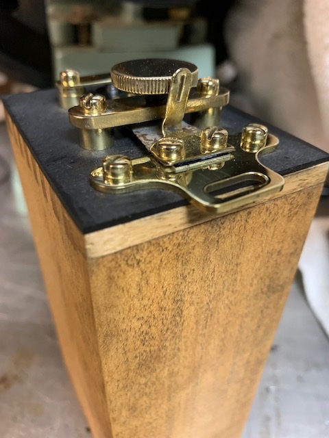

Just FYI, I started making and repairing Kingston coils.
I attached a few photos. Happy to help.
David Woods

Post by Moxie26 » Thu May 04, 2023 7:35 pm
Hopefully Jim Golden will contact you .

Jim.... Click on his name , "Woody23" ,from his picture post and send him a private message thru our Forum. I'm sure he will respond with the help you and your friend needs.

Bob, you are 100 % correct and David has been a great help!
I have learned a lot from him.
He will build what I was asking about, new early size coil cases with the new type coils inside.
