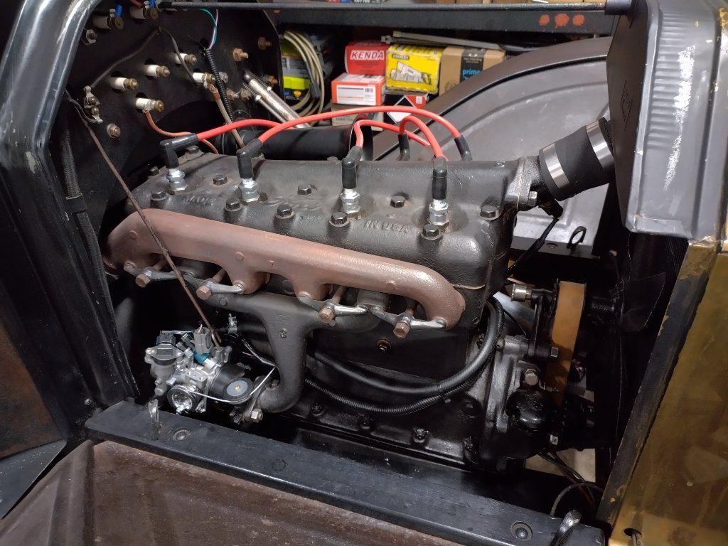

Some of you may have seen this on the Facebook model t page but I wanted to post a couple of photo's here also. Spent the last year and half working on this. I've been wanting to learn about DIY fuel injection for several years and finally decided to use my 16 t for the project. This isn't so much to replace the carb and Ford ignition but more of an experiment. Since my t is a hobby vehicle I could let it sit for awhile during the project.
In a nutshell I'm using a Honda CB250R integrated TBI, VW smart coil and a Speeduino NO2C DIY kit. Merging modern electronics to a hand cranked primitive engine was quite a challenge but I figured out a work around for most problems. Still in the tuning stage but it's slowly running better.

Is that a thermocouple for coolant temp on the hose flange at the head?
________________
**FATE**
fbergski
Posts: 118
First Name: Philip
Last Name: Berg
* REQUIRED* Type and Year of Model Ts owned: 1911 Touring 1916 Coupelet
Location: Simi Valley CA
Re: Fuel Injected t
Post by fbergski » Mon Jun 05, 2023 2:38 am
GM temp sensor

How do you prime for hand cranking?

(1) How are you timing the coil system? I get the Honda syatem as a "smart coil" but you need some way to time the thing.
(1a) Do you still have manual control over the ignition timing, and if not, how do you keep from fracturing your arm?
(2) Does running this result in a cleaner/smoother/more bulletproof running T engine?
(3) Are there any performance plusses and/or minuses?
(4) What's next? Turbocharging? A blower? (I'm guessing at that point pressure oil would also be in the mix)
Here's some answers:
(1/1A) Anderson timer is used, advance/retard is manual just as Henry designed it. I designed and built a couple of circuit boards to fire the VW smart coil from the Anderson timer.
(2) I haven't shot a bullet at the engine yet so I can't say, still tuning.
(3) Still tuning, I can say that my engine does not like to run stoichiometric (14.7:1) like modern automobiles. My guess it has something to do with cam design and overall engine design.
(4) No further mods are in the future except getting the ECU to control timing. I have to create a circuit for that and at this point I have other projects that need attention

AndyClary wrote:
Mon Jun 05, 2023 8:58 am
Andy
I use a Arduino Nano running a simulated rpm program to "trick" the ECU to fire the injector when hand cranking. Once it starts the ECU takes over.
