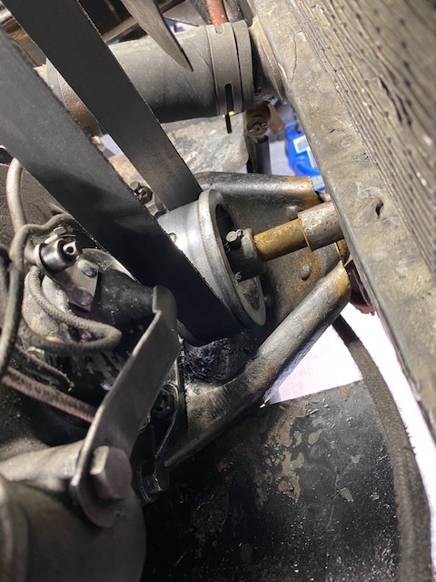

I’m checking my TW timer position against the initial spark when on Batt.
A forum search advises first spark should occur 15 deg ATDC, and that TDC occurs when the crank pin position is horizontal. Fair enough.
My challenge is that the crank pin is hidden by the radiator, crank, pulley and fan belt. See photo below. I need an easier way to determine TDC.
My understanding has been that when the hand crank is vertical (or possibly horizontal) that one cylinder will be at TDC. Is this correct, assuming the hand crank is not twisted)?
If so, then my initial timing is way off, as first spark at full retard on Batt occurs when the hand crank is 40 deg ATDC. This is consistent over cylinders 1, 2 and 4. Cylinder 3 is 10 deg sooner; a different issue and I’m pulling the timer to investigate.
In the meantime, where exactly is TDC when the hand crank is vertical?

To locate TDC, in relation to the starting crank, in relation to your motor...pull the No. 1 sparking plug and turn motor by hand crank to get TDC - both intake and exhaust closed. Note location of starting handle.

You have an aluminum crankshaft pulley. They are usually split, with a clamp screw to secure them tightly. That split line runs perpendicular to the crank pin hole. Use that as your reference. At TDC, the split will either be at the 12 or 6 O'clock position, depending on how you mounted it. Determine if it's on the compression stroke by placing your thumb over the #1 plug hole while cranking. When you feel a puff, you're on compression. Then, just get the split line vertical and you're on TDC.

Remove the #1 spark plug, insert a wire like a coat hanger wire into the spark plug hole and angle it to ride the piston. Watch the wire go up and down as you crank the engine over. You will see TDC easily.

I assume you're dealing with a 24-27 T with a radiator apron blocking your view of the pin. While crank position may get you close to TDC, most crank ratchets are worn enough to be off a little. I would use Jerry's method to find TDC. Remember that contact is supposed to be at 15º past TDC. Thinking of the pin as a clock hand, that's halfway between 3 and 4.

Going from TDC to 15 degrees past, the crank handle moves approximately 2 inches.

An old trick was to use a straw from McDonalds resting on the piston. You can also use a dowel, a metal rod, whatever. Or do it with a friend and have him/her watch the crank pin as you slowly crank it. Lots of good ideas here. Remember, if you go to far, 2 times around and you are back at TDC. If the crank is tight, loosen all 4 plugs and it will be much easier to turn.

If I'm not mistaken, and sadly I often am...lol...as I recall from my own experience I believe when the crank pin is horizontal, and you "mate up" the crank ratchet into it, your handle arm should be almost the same position, as well as looking down the radiator at the crank ratchet, you should see the pin that holds the ratchet to the arm. Pretty sure anyway. Give it a try and a look-see. And good luck! Best thing is, you're also using what I consider the best timer on earth.

If I’m not mistaken there is a pin that you had to drive through the pulley & crankshaft, by locating that hole where the pin was driven through and marking it on the front of the shoulder of the pulley with and indelible marker you should easily see the position of the pin. You may even mark both sides 180 out on the pin holes location with different colored markers so you can note the position of the piston. Around 3:30 as on a clock is 15 degrees ptdc I believe. Could be wrong though.
