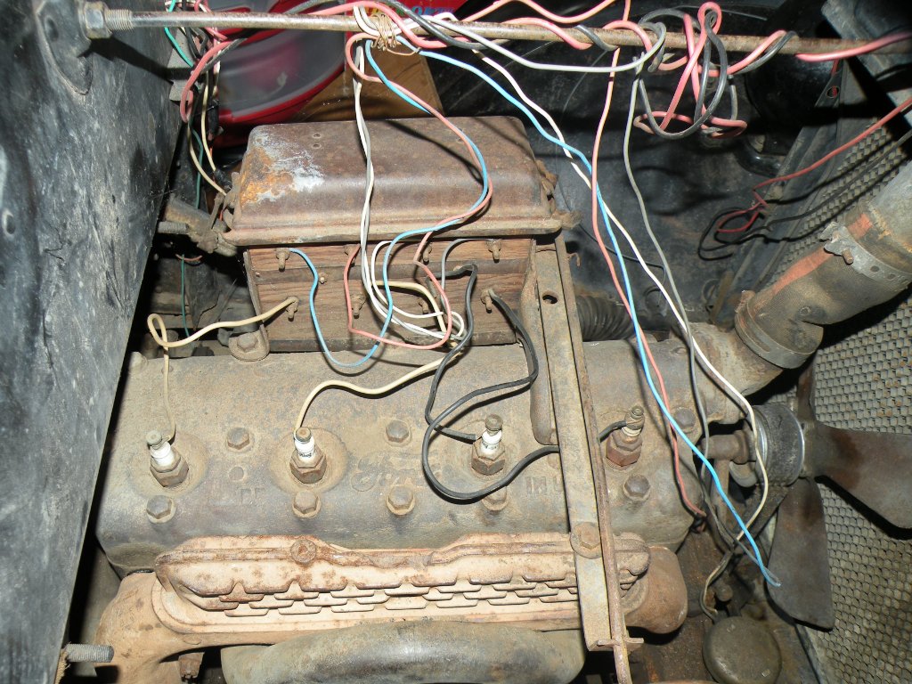

I got this motor in Mothers Day 1963 for $9. It was stuck , Snow on the ground and cold. I got a frame and 2 axles with it, No radiator and nothing else.
I was 17,no T knowledge and less cash. When I got it unstuck I had to use Model A manifolds and carb as that is all I could find. Parts and a body were found and it was last ran in 1971 in the Gold Discovery Parade at Custer SD.
The choke rod and timer rod were disconnected prior to the pictures. the ring gear is bad so I always started it with the crank which shows a little wear.
How long would the keepers on 2 & 4 intake valves go before they fell out. It still has fairly good compression when pulling on the crank on all cylinders and no stuck valves. I want to put T manifolds and an NH carb on it.
Have a laugh, pick it apart and let us see what can be found. It is always interesting to see what others find in photos.

Very interesting…. Taper leaf front springs and aluminum crank handle that was discontinued on 4 April 14 by Accession 575. But a 1 piece valve cover introduced in early 20s sporting a New and Improved coil box…. Get it ready for the Nat’l Tour this weekend 😜

I don't see anything to laugh at or pick apart. What I see is a mix and match or not. Some people call it a "parts salad", others a "Johnny Cash car". A bunch of parts and pieces stuck together to perform a task or purpose. That is also a major part of the model T's place in history!
I want to see more pictures of it!

Looks like either a 26 or 27 car. The sediment bulb is for the under seat tank. You need one which has the bulb at the bottom for your car, It is useless as is because the gas is supposed to go through from the top with the bulb hanging down to catch sediment. So that needs to be replaced. If you use an NH carburetor you will need the rod through the center of the engine between cylinder 2 and cylinder 3 to connect directly from the steering column to the carburetor. Also remove that rod in front of the coil box. See my picture.

The sediment bulb I know was wrong,you cannot see it but the handle is broken and if you saw the other side there is no spring, no washer, no cotter pin and no protrusion to hook any of that to.
That rod and flat bar accross the top of the head is part of the throttle linkage. On the left side there is a small chain connecting it to the throttle rod on the steering column.
Number 14 and 16 household wiring worked for timer and spark plug wires. Also for other wiring. The fan mount was to be on the head but I did not have one. Number one timer to coil wire was hooked to #2 timer post because the rod had to go under the radiator hose and would not reach to timer correctly so move the wires. It worked but I will make a new rod so it will work better as I never had much power so I think a lot of it had to do with the power. I put a Ruxtell under it and the shift lever is an emergency brake handle mounted on the right side.
Needs a little work, e brakes, correct windshield frames,outside oiler, correct front spring, 2 more wire wheels, possibly some type of seat cushion and a couple of other minor things. Got to find my #65 key around here somewhere.
I never want it as a fancy restored rig as that takes the history away from it. I would rather have it as the dakota ridge runner it was as I had to go along a couple of ridges to get home as there was not enough power to go up the main road Hills.
It is for fun not show.

The only thing that I noticed was that your right fender support is missing a bolt/rivet.

Looks like Model A carb and manifolds, and an interesting throttle linkage. Have I got that right? How does it run on the Model A bits?

the only thing I'd change is replace the spark plug wires with barbed wire so that it can hurt you even when it is not running.

Cannot get a photo at present of the whole pickup. The box is bant up a little and I only got the box shortly before I left SD 54 years ago. Have to see if I can find an old picture of it as a flatbed.
It seemed to run OK with the A carb but I believe my lack of power was timer settings. Kicked back a few times cranking it..When I was running it my exhaust pipe and muffler were from a 58 Ford and the pipe was jammed into the manifold and held with bailing wire. It was run with bald adapted 16 inch wheels and tires on the rear and 30 x3 1/2 on the front. Windshield frames were straight bottomed but worked. There is a fuel shut off valve screwed into the sediment bulb. It had no floorboards and an old foam cushion for a seat.

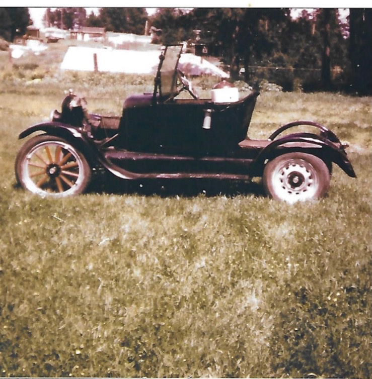

No current pictures at this time but here are a couple as I ran it 50 + years ago.

Great photos, going for the moonshiner look? Or were you in fact a moonshiner back then? I like the stoneware jug. Rear wheel looks similar to vintage VW but probably not. Thanks for posting the pics, here's one for those who don't want to download.

I have a pair of wheels welded up JUST LIKE those! to rusty now to use but wow, a second pair!

Looks like a '36 Chevy wheel (6 lug bolts) or a '30s Plymouth or Dodge wheel (5 lug bolts)

So the car was built in 1971.
That means it has been like that for 52 years.
That makes it 'older' than many of the used parts were when the car was built.
That means it has 'existed' longer than the original cars that donated to its construction.
That makes it a genuine 'correct classic' in its own right :-)
