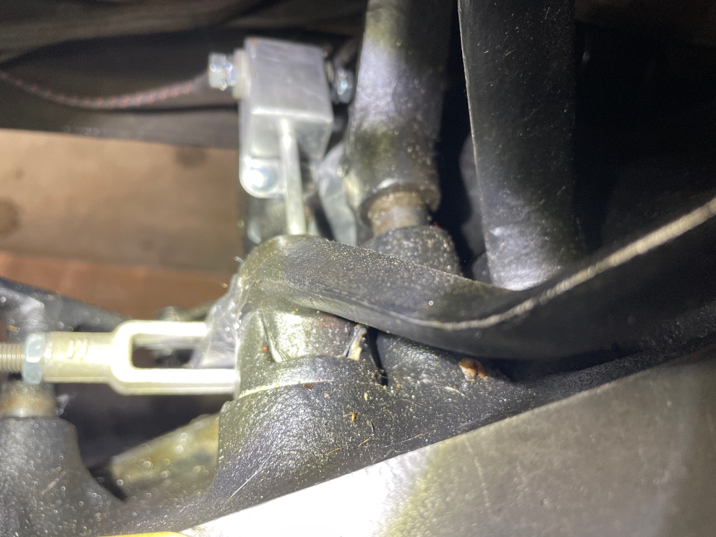

Thanks Scott. The reverse pedal does not sit lower than the other pedals at rest. I adjusted it so that the reverse pedal engaged fully when it was just a bit lower than the other two pedals when it was pressed. You can see the pedal at rest with the parking brake on in the photo attached.
I don’t have a lot of play on the pedal shafts and the hey don’t leak a noticeable amount of oil. The cams don’t look worn and start to cam pretty quickly and hen depressed. You can see the out side cams below.
Deformed bands would be a pisser. Only way to check would be to pull the engine.
Brake pedal and cam.

Reverse pedal and cam.
The cam surfaces on the low and brake look ok to me…
I backed the low pedal adjustment off half a turn and it’s not dragging when the brake lever is back half way. I have free neutral and can roll the car in that position.
I am concerned about brake and reverse bands dragging.
