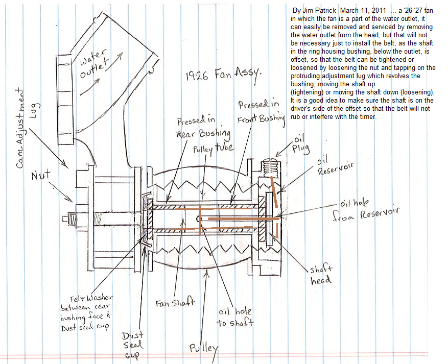

There was originally a brass slotted plug to be removed for oiling.
The felt washer goes in a cormed rear cap. The felt floats in a space between the shaft & the cup. the shaft (large OD) area is longer than flush to the bushing for this purpose.
Motor oil to lube. Greasing that zerk is OK. Grease makes less mess over oil.
Ream is standard 5/8"?. Sfaft has the clearance built in. .oo1 probably too tight.
Dont make fan belt tight. It should slip easily moving the fan by hand. Tight is unnecessary & will wear the bushing fast.

Re: Fan pulley oil. What the zerk? Ream? Felt?
Post by TRDxB2 » Sat Jun 24, 2023 2:13 pm
Here's where things go - there is a later long neck pulley but everything else is the same.
The shaft needs to be held tight while allowing the pulley to spin without much lateral movement.

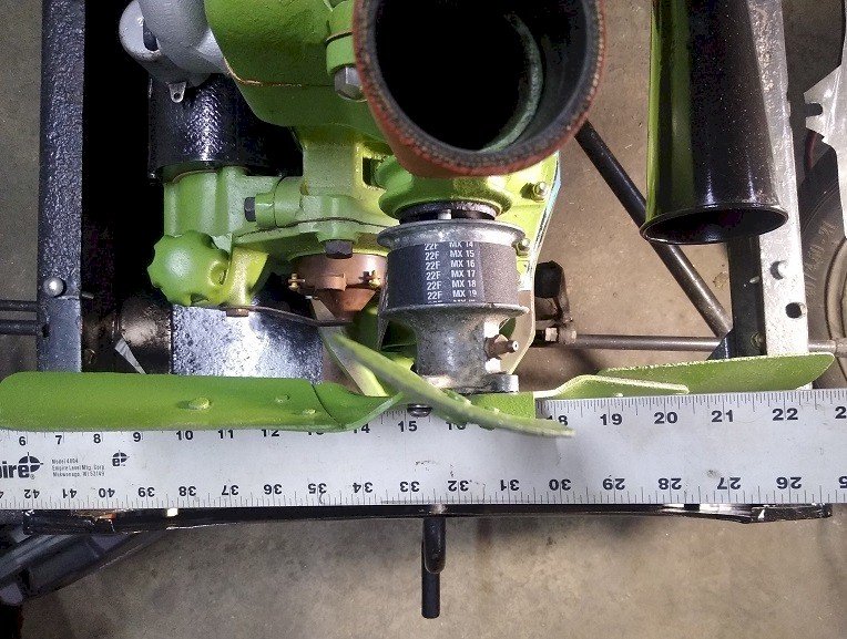

Post by varmint » Sat Jul 01, 2023 3:00 pm
Had to relearn how to use adjustable reamers but the fit is nice and spins freely.
Made a washer from a roll of felt.
The 1/4" pin fell out on me a couple of days ago, figured that could be bad on the road.
fan pulley03.jpg (47.19 KiB) Viewed 4849 times
fan pulley04.jpg (44.08 KiB) Viewed 4849 times
fan pulley05.jpg (78.53 KiB) Viewed 4849 times
There were only three screws for the fan and one of the threaded holes was gacked up & malformed...explains the missing screw. So, I chased the threads and may have inadvertently upgraded a size #14 for a 1/4" for all four holes. Found some 1/4" Philips round heads and converted them to slotted. After the center bolt was tight, I cranked it several times and the belt runs true. The belt has not yet been tightened on the pulleys and won't be until it's time to run the engine. I lubed the bolt before insertion and already had drips from the back side on top the crank pulley below.
Vern (Vieux Carre)

Post by speedytinc » Sat Jul 01, 2023 5:11 pm
You try that fan hub with your radiator?? That hub is normally used on the super economy radiators shipped to the west.
They wont fit a normal thick radiator, especially a new Rootleb unit.

Post by varmint » Sat Jul 01, 2023 8:29 pm
It is the pulley that came with our Model T.
No. I have not tried it with my radiator.
The radiator that was on it was stolen for scrap before I bought it.
Vern (Vieux Carre)

Post by varmint » Sat Jul 01, 2023 9:06 pm
Fan is installed on the pulley. Guess I'll have to see if what I've got will work.
I am curious about what super economy radiator means.
This October '26 coupe had wood wheels, not spoke,
a Kingston L4, not the Vaporizer,
and now I learn a super economy radiator.
The Ford assembly plant here in New Orleans was shipping a lot to South American countries and this paints a picture of cheaper cars.
Vern (Vieux Carre)

Post by speedytinc » Sat Jul 01, 2023 9:25 pm
Super economy was a 2 row core. Saved ford money. Very poor cooling capacity.

The adapter that brings the fan closer to the radiator on The late 26 - 27 cars was used when the car was equipped with a three-row tube radiator instead of the five row tube radiator.

That fan in your picture looks a lot like a fan that was on a 1954 flathead six Dodge pickup I once owned. If you plan to use it on your Model T, now would be the time to buy a modern fan pulley with the modern bearings, it will move your fan back some from your radiator, which I am sure you will need to do. If you do have a tin core radiator, then I would find a stock late Model T fan to use.

This is the fan that came with our T. I had no idea that it was not stock.

Post by varmint » Sun Jul 02, 2023 9:57 pm
I mocked up the radiator and there is 3/8" clearance. Totally don't know the speck. Rotated the fan by crankshaft and nothing hits. I could purchase the fan to make it correct but not sure if a stock fan will stick out more than this one.
Vern (Vieux Carre)

Vernon
do yourself a $1300 favor and locate a standard FORD pulley (or modern ball bearing replacement) and install it with whatever fan tickles your fancy
yours (above), vs standard pulley (below):
Photo courtesy of Ron Patterson

Vernon, some observations, made possible by the photos you posted.
The fit of your mix of components looks OK, BUT,
The fan is not a stock T fan.
The radiator is an aftermarket replacement. The side panels are like none I have ever seen, and the mounting points at the frame likewise.
For that fan/pulley assembly to fit as it does indicates to me that the radiator is of the thinner core variety. On Ford thin core radiators, at the back of the bottom tank, there is a blank area where the extra two rows of tubes would normally go. Yours does not have this feature, indicating to me that the whole radiator is not a Ford part.
Will it work as it should? Perhaps, but not as well as might. You have nothing to lose trying it.
To get to a standard Ford set-up, you will need a different pulley, standard T fan with parallel sided blades, and a new radiator.
Hope this helps

Post by TRDxB2 » Tue Jul 04, 2023 1:41 pm
Oil or Grease? Look at the path the lubricant needs to flow & decide what to use.
Drawing by Jim Patrick...
Expected lubricant flow
-Oil plug/grease zerk into reservoir in pulley behind fan then passing through the oil hole in the fan shaft and out another oil hole in the shaft that is in a void between the two bushings in order to lubricate them. Excess lubricant in the front busing is self contained, any seeping out the rear bushing is "retained" by the felt seal. As the pulley spins centrifugal force will cause the lubricant in the reservoir to be driven away from the front oil hole in the shaft while simultaneously causing the lubricant in the void between the bushings to cause lubrication.
So the questions:
-What lubricant will settle down into the reservoir when the engine is off in order to flow into the fan shaft tube etc.
-Does the design rely on capillary action to cause the lubricant to flow from the reservoir into the void between the bushings via the shaft tube ?

Again, had no clue there was a rogue fan on there. The imposture has been removed and replaced this morning.
Vern (Vieux Carre)
