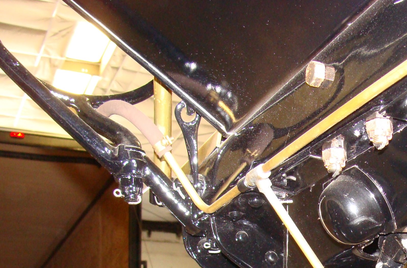

Re: Need info regarding '11 Torpedo top strap attachment point at front of car
Mine are like John's
Here is the loop on the fender iron:

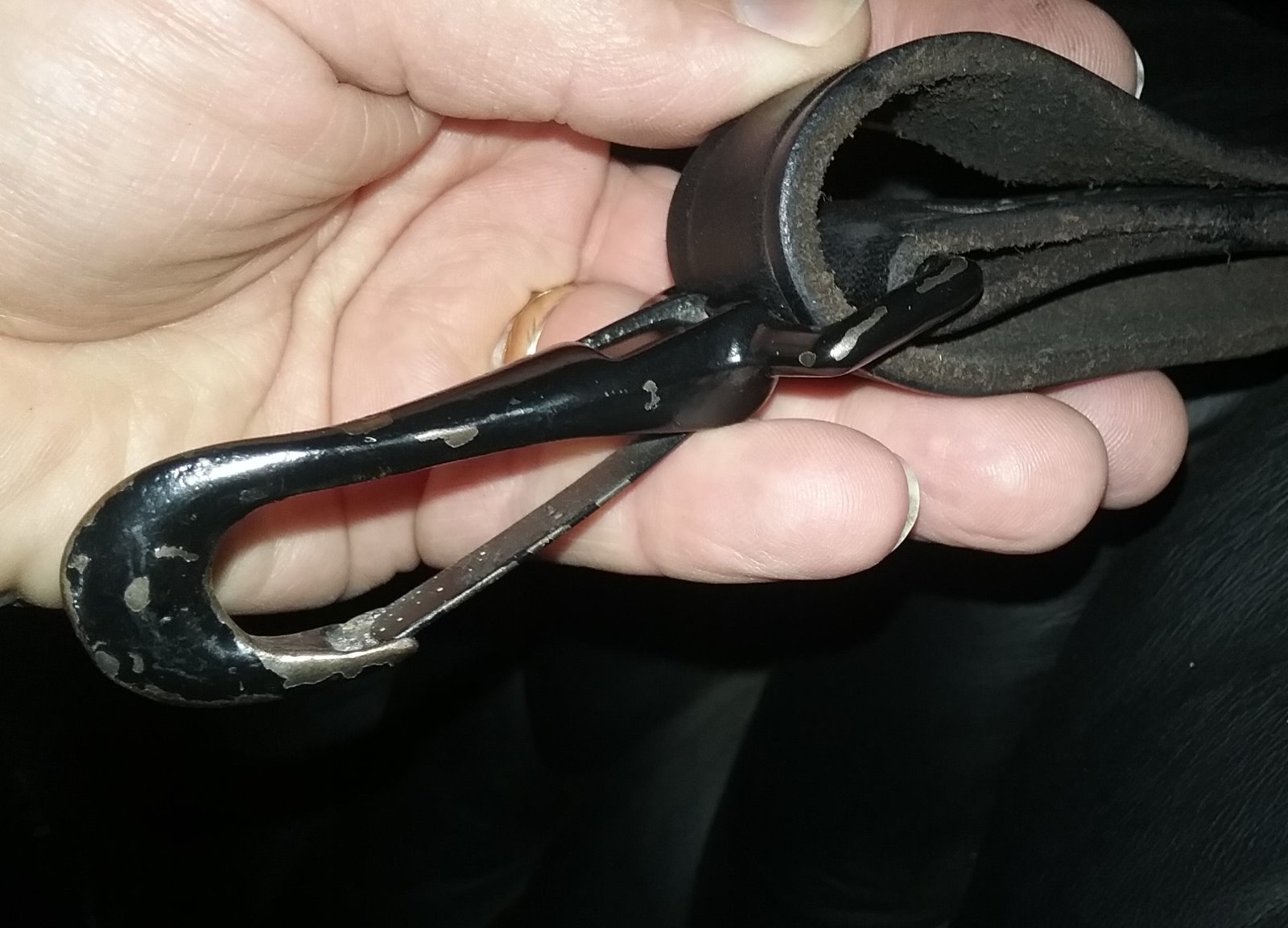

Here is the hook:
Here is the hook:
I don't have a pic of the brass plated steel twisted figure 8 loop, but it mounts on the side of the frame with the fender iron bolt.

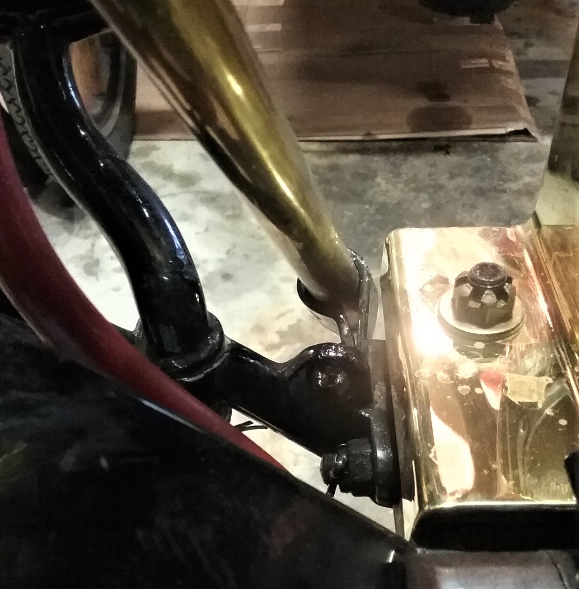

Topic author - Posts: 6619
Keith
so good of you to respond and provide pictures! Many thanks for your info and effort.
I have since found that both front fender irons have 1 long and 1 short bolt holding them on...at first I thought it was sloppy work from the past, which it sort of is, as one bolt on one side is the front-most bolt and is the rear-most bolt on the other side...
I now realize that the long bolt likely held a figure-8 tab and that is what I intend to use. At the present time, the straps are held with somewhat crude brackets affixed to the radiator stud...I know that this is a version of "correct", but believe the evidence in front of me speaks to a frame-mounted figure 8 loop.
Many thanks again and regards to you and all responders...I have what I need now!
