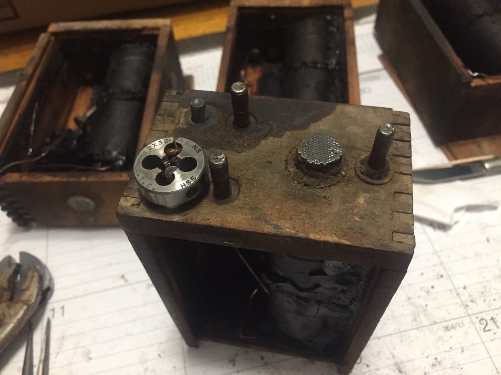

Now is the time to address the hardware. Fortunately someone had removed most of the nuts. The rusty one that shown above with the wrench I ground off and replaced it with a spare I had from a bad coil. The others I cleaned up with the wire wheel and put marvel mystery oil on.
I like to clean the threads with a die. I had to special order at 12x32tpi Die so I made sure it was extra small so that I could get it to fit in here.
The hardware that fell out I would pull out and hold with a wrench to clean up the threads. But I did get one stuck in it was a pain to get the day off I mean she is a screwdriver from the inside. I will use super glue to hold all the loose studs.
