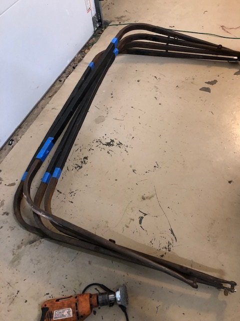

Hello all, I am finally getting to putting in 1922-23 two man top on Shirley. According to the Classtique video https://youtu.be/h6Y8gKaKIrs you stick the bow wrap on with Pro Stick then staple it on with an air stapler/brad nailer. What size staple is used and what air stapler model will work? -- IV

Ignacio, I do not know why she stapled and nail the bow wrap. As I recall there should not be any staples or nails on the top of the bows because it can eventually wear through the top. I will have to watch the video again, but another party said to sew the bow wrap across the top of the bow with a long running stitch. That is how I did it so there is no chance of any wear. What she has done on the front bow is OK, because you will be tacking and stapling the top to the front bow. Dave

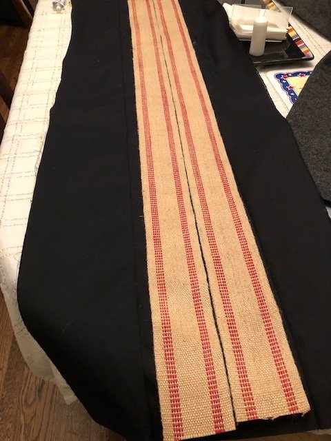

The easy way for the wood bow bias wrap is to cut to fit, wrap, then spray a light coat of adhesive, like 3M, on the wood bow, pull down the cotton drill and it will stick. Can't think of sewing there, no room to pass a needle, as the bow drill needs to be tight to the wood bow.
Wetting the curved portion helps reduce wrinkles there, as the bias cut drill will pull and fit nice, takes patience. If you have to use staple or tack, seat it well with little protruding. On original bow drill remains have pulled off, the drill was tacked, but only on the upper center of the bow. And....the leading edge or nearing up to it, was tacked a thinner felt, about 1/2" wide, somewhat like the felt on the hogshead or at the dash. Was placed over the tacks used to fit the bow drill. That protected the top cover too.
Remember, the top cover rides only on the edges of the wood bows, when you fit the irons and suspend the wood bows where they will be erect, you can sight and determine where the top will lay....it will pull along just the leading edges of the wood bows.
As for a stapler, the air ones are nice, small, and the nose is so small it fits into the Hidem welting strip too, holding the channel open as you staple the finishes to your top. But use tacks in the long nylon or webbing top support runs from the front bow to the rear tack strip, you want to really have secure webbing for the top cover support.
Only the top pads will you need to learn to sew......it is simple. Get a long curved needle and heavy black thread at a women's fabric store, and just place a lazy lacing along and thru the canvas wrapped bow padding as you cover it with the cotton drill.....you can do it :lol: But if you are scared, use a thimble to prevent a bloody stick!

I stand corrected. Yes you can use staples or tacks on the bowdrill. I would buy the stainless staples and the galvanized or aluminum tacks. There will probably be a lady at the store that can show you how to sew the pads. It is quite easy. I cannot add anything more than what dan told you.
Re: 1922-23 two man top.
Post by Rich Eagle » Fri May 17, 2019 3:53 pm
The bow drill was tacked originally but I like to stitch it like the pads photo shows. This allows more twisting to remove wrinkles. The stitching doesn't have to be pretty.

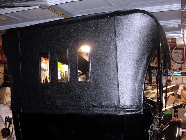

Post by ivaldes1 » Thu May 23, 2019 11:58 pm
Painted the bows.
I wasn't too excited about needle and thread sewing the bow wrap at the metal parts like in the Classtique video. I asked my 82 year old Mother for advice as she observed me struggle with needle and thread and she said to just use Fabric glue. I asked her if that was cheating. She denied that it was cheating. Thus with that permission I went forth and glued away with 'Super Fabric Adhesive(tm)'. So my bows are wrapped and on the car and on to the next steps.

Further along. The Classtique video is for a 1 man top. I have a 2 man top so my front rain flap is different than in the video. I understand that the sewn part is what goes on the window hanging down but I do not know otherwise how it goes onto the front bow? It is 60 inches so I presume that it goes on the curves as well? It is more material than needed to wrap the bow. Do I double wrap it or wrap it then trim it? Tacks or staples? Tack or staple which surface?

Overall picture so far:

Straight:

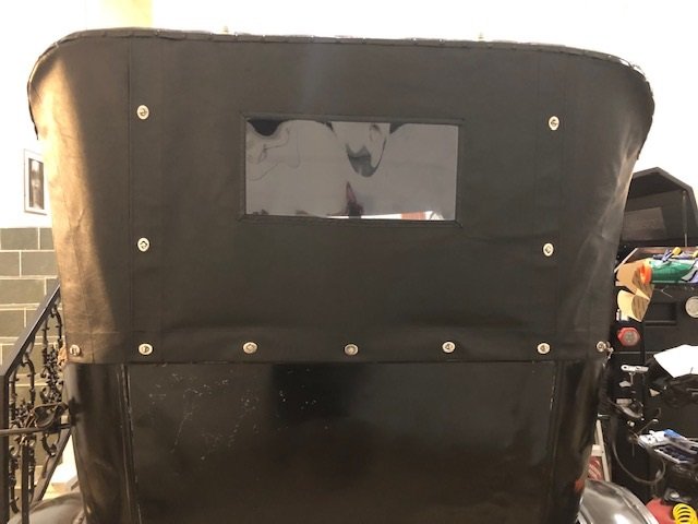

Pictured are the rear curtain straps, leather. So I take the d loop off and nail it on to the bow and tack strip through the leather? I will have to remove the loop rivets to get enough length to reach the bow and the tack strip right? How do you remove the rivets without damaging the leather?
After all that you punch a hole in the leather so that the buckle works?

It took me awhile to get the orientation of the back parts.
1) So the Common Sense's go in the rear tack rail and I tack all of this to the top?
2) Why did they leave off the 2 male Common Sense's on the straight edge of the side curtains?
3) I assume the rear window curtain goes inside the side curtains and that they overlap about 2 inches?
4) Are the 2 straps pictured for the purposes of rolling up the rear curtain? If so, does it tack to the rear bow and just hang down when not in use? If so, where do I place the male Common Sense's?

Ignacio, You rear curtain and front straps should be woven web straps, not leather. The woven webs don't have buckles like leathers do, they've got slip buckles sort of like web belts for pants have and they're easier to adjust. I didn't bother to drill out the rivets on mine, I just cut the strap high up near those rivets, so that I had most of the material hanging below the tack rail, so I could really mount it with good sturdy nails (these straps on the back take the stress off the rear curtain when you erect your top, the front ones pull forward and the rear ones keeps the stress of the curtain and place it onto the straps).
So, you got a roll up real curtain too, eh? Can't for the life of me figure out why, I know most people say putting a top on your car slows it down some, that's true with 1 man tops, but not with 2 man tops. 1 man tops have gypsy wings that wrap around the real bow to the second bow and snap on, this cups wind in the rear curtain. A 2 man top doesn't have that, so no wind isn't caught by the curtain. Anyhoo, those straps you're holding are to hold the rolled up rear curtain, they nail to the top of the rear bow with a standoff nail, that the eyeholes hook onto.

Ignacio, you don't drill through the rivets on your bows, you feel for the old holes on the inside corners of your front and rear bow. You'll feel a slight depression as though there might be a hole there, push the tip of an ice pick or awl in and feel around for the holes, they're there (believe me you'll find them if you feel around a bit). Me when I was covering by bows I marked them, so I knew where they'd be. Also you may have to bend the screw tabs on the footman's loop a bit to fit the curvature of your inside corners, I did, but then my footman's loops were new, I didn't bother using the originals again. When you find them, make a small hole with either the point of an exacto knife or a nail, just so you can start the screw. Drive the screw all the way down, if you have to, cut any excess bow drill that gathers round the screw (I just used the screw and ran the knife round it). Then remove the screw(s) and put your footmans loop on. The other thing I should mention, is that the screws they sell with those footman's loops are fine thread machine screws, I went down to the hardware store and bought the same finish but wood screws, I wanted to make sure they bit into the wood in the corners (never sure with a machine screw, fine or corase thread).

Progress, I have a side pad up. Used the Royce Peterson method of gluing down the burlap then nail it up.

It is done! Royce Patterson's article was very helpful: https://modeltfordfix.com/installing-a- ... r-model-t/
Here are some pictures of the final results: 1) Top pad stapled down. 2) Again, 3) Weather flap side. 4) Back curtain on. 5) Top deck on.

Post by ivaldes1 » Sun Aug 25, 2019 12:34 am
More pictures:
Completed.
Completed.
Rear curtain rolled up.
Rear curtain down.
Rear curtain down.

The back looks nice, but you should've pulled harder on the top deck sides, those aren't going to come out in the sun...the fabric doesn't shrink it expands, soooo, it going to get looser. I stretch and pulled my 3 times (first both ends, they both sides, then repeat) until I could bounce a quarter off any place on the top...you might be able to pull them out once the top deck gets really good and hot, but you might need a pair of canvas stretching pliers to do it though or some very strong fingers. The excess will show up on the ends though...you might have to judge which end would be easier to remove it from...to me the rear would be easier, but I'm not sure with that roll up back there...looks nice though.

Post by ivaldes1 » Mon Aug 26, 2019 11:32 pm
Thanks, forecast is mid-90's through labor day so I may get a chance to re-stretch it.
