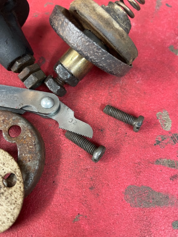

What size are the mag post, starter, and bendix screws on a 19-25 Hogshead. What about the threads where you bolt it to your pan?

Mag Post 3/16"(X) ....Should be 10- 32 x 1/2'" or 5/8" L Pan head single slot, L depending on year of post
Starter 3/8"-16 x 1/2" (X)....Should be 5/16" -18 x 7/8" Round head single slot
Hogshead Cover Door 5/16"-18 x 1/2" L Dome head single slot
Bendix cover 14-24 (obsolete thread) x 3/4"L Round head single slot w/lockwasher (correct from vendors, not hardware store item)
Hogshead to block. 7/16"-14 x 1 1/2" L Hex

did you really mean 10-32 instead of 3/16-32?
3/16-32 is BSF Fine (Whitworth Thread) and I'm pretty sure that is not called out here, though I don't have access to a drawing

Well, that dimension source 'as-is" from the Bolt Listing on the Gallery, icon in the upper right of the Forum page. Took it for fact, so will send a note to have this pdf page changed.Scott_Conger wrote: ↑Sat Jul 08, 2023 9:30 amDan
am I about to learn something new this AM?![]()
https://www.mtfca.com/phpBB3/app.php/gallery/image/1500
Should have known too, that 3/16" wasn't right, did know it is a very fine thread, and takes care to place it, esp. in the alum hogsheads.

I have to make a correction.DanTreace wrote: ↑Sat Jul 08, 2023 9:24 amMag Post 3/16"() should be 10- 32 x 1/2' or 5/8" L depending on year of post
Starter 3/8"-16 x 1/2" Round head single slot
Hogshead Cover Door 5/16"-18 x 1/2" L Dome single slot
Starter mounting bolts are 5/16-18 round head slot & seem to range in length from .830-.875 (7/8)
