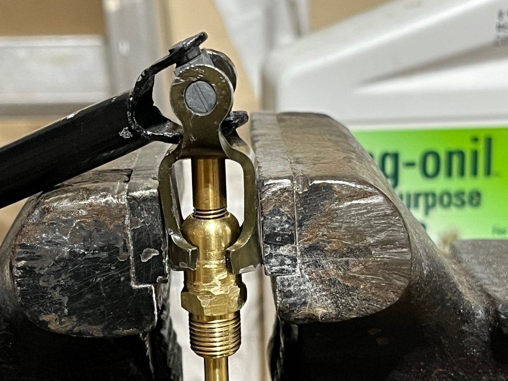

A picture would help. Common issue with repop 26-7 needles: the friction tabs are too long & dont allow the needle to fully seat.
Your needle is not really only a 1/4 turn off the seat. A proper condition NH wont run @ 1/4 turn off the seat.

John Karvaly, You pointed out that the friction tabs on 26-27 repop needles are too long and suggested a picture. The attached photo shows that could be my situation, especially if you zoom in on it. I assume grinding the ends of the tabs would correct it, even though that may be difficult.
Thanks! I doubt that I would ever have thought about that situation!
- Posts: 4725
Re: NH Carb Spray Needle Adjustment
Yes it appears that the tabs are hitting the hex. You can trim them or get the brass fitting shorter by one thread. Either thread the brass piece a little more or thread the body a little deeper. 1/8 npt thread. You dont need much, just 1 threads worth.

One: the brass post on top of the carb that screws in - that is a tapered pipe thread and the part is made wrong. The tapered thread is too large in diameter...the hex should be able to run down and either touch or nearly touch the top of the carb. Don't try to tighten it more...it won't go. You will have to buy a split die to run on successive times, each with the die a little smaller, trying to thread the part onto the carb after each time you run the die onto it. When the hex seats against the carb, you're done
Two: the two "fingers" which clamp over the above part usually are too long and crash into the hex before the needle seats. You will need to cut off about 3/32" length of those fingers.
Once the brass fitting is short enough as installed, and the "fingers" can run down further, you should find that you can turn the needle all the way down and gently seat it against the jet in the carb. Thus seated, you can now unscrew 1 1/2 turns, start the car and screw back in until the car runs correctly after it is warmed up.

Here is an update. Steve Lang saw my post and called me. He described my problem the same as Scott did. He offered to modify a brass post and send it to me. He did two modifications. (1) Removed a small amount of thread in the top of the brass post so that the needle will screw further into the post. (2) Used a die to decrease slightly the size if the pipe thread on the bottom of the brass post.
I shortened the friction tabs using a Dremel (see photo).
My problem is solved. Thank you all who responded to my post. A special thanks to Steve. He has also helped me on other items. What great technical resource and representative of Lang's!
