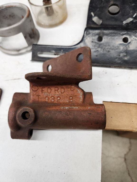

I have quite a few steering brackets and most have just the number or number and Ford script, I just found this one has 2 sets of numbers and Ford is in block letters, Gails book does not show this, any ideas what year this might have been used? Bob

The T-932B is the bracket for 1917-1925.
Could be non-Ford mfg, as Ford would use trademark script on this part beginning 1919-to-1925.

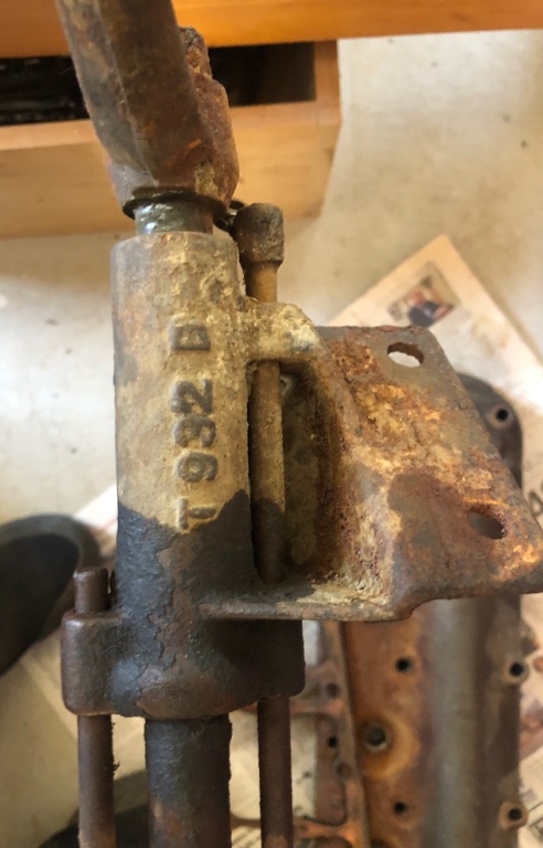

Perhaps this isn't relevant. This bracket is on an original 1914 column.

Your’s is correct ‘raised’ cast numerals , on the underside of the barrel, reading away from the dope cup hole end, this style is 1913 to early 1915.
Later 1915- 1917 styles the numerals are cast ‘depressed’ into the underside of the barrel, but alignment is different, as they read toward the dope cup end.
Most later 1917- to maybe early 1919? styles are similar, but now the cast-depressed in numerals are on the top side of the barrel, and read toward the pitman arm end.
All the other T-932B to 1925 are mostly same, but now a Ford script and numerals are cast depressed into the top side flat area between the barrel and the mounting plate.
Bob’s unusual T-932B has those cast depressed numerals, on the underside , like ‘15-early ‘17, but the T is odd with serf on the letter, and run opposite direction, plus the casting hollow depression seems different shape. And oddly another set of numerals with Ford in block , not on the top side of the barrel, but like later ‘19-‘25 on the top side of the flat.
Either Bob’s is aftermarket, or is transition piece around 1919 when Ford got serious on marking with Ford script on parts, could be a supplier put block Ford letters on top side in tooling practice to see how the marking should look in the final change to location on the top side flat area.
