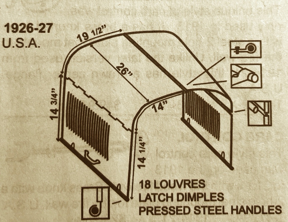

Your '26-'27 Coupe body is radically different from a '25 coupe, for one, the gas tank is in the cowl.Paradise Garage wrote: ↑Mon Jul 17, 2023 7:29 amSo the body is what is changed? So there is no easy way to goon it up to fit?
Good news is you have a '26-'27 chassis, so at least the body will mount correctly to the frame brackets and both must match.
Now the bad news, the radiator is low style '23 and before, shell and the hood are earlier and hood is narrow at the cowl, and the fenders and headlamps are '17-'25, but they hang because of no fender/headlamp arms of '25 and earlier, as the '26-'27 fenders mount to the chassis.
No easy way to match, get a high radiator and shell, and a '26-'27 hood which is wide at the cowl to fit your body, and '26-'27 front fenders too.
Here are the hood measures to see what year hood you have, and the '26-'27 hood dimensions that will fit your Improved Car coupe body.
- Posts: 6587
Re: 1925/26 coupe project
The easy tell on the hood is the number of louvers on the side panels
