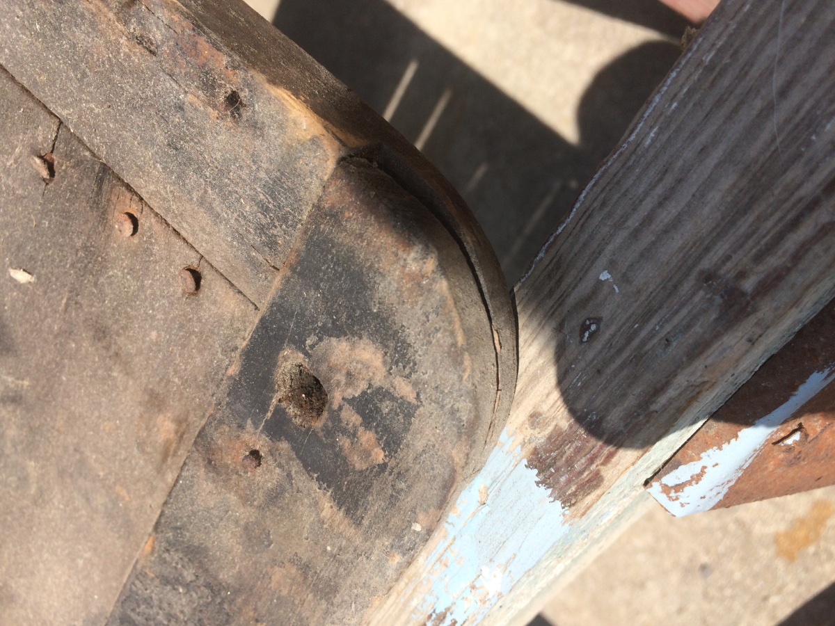

As a matter of fact John; here are the pictures: Touch the first picture. Then it’ll be rightside up. See it’s taken from the left side. There’s a frame with a mounting hole in every corner. From left to right there’s 3 pieces of 3/8” hardwood. A wide in the ‘front’ and in the ‘rear’ with a narrow board in the middle.

Thanks for the photo! I wonder if the runabouts from 14-22 had very similar trunk wood.
I located a really nice 1919 trunk for mine and it had the framing at the bottom all around and the center piece like yours but no floor.
I used cabinet grade plywood for the wood deck under the trunk that’s part of the rest of the body. As I remember now I had plans for the runabout from Mel Miller and he may of recommended to use plywood for the rear deck wood also.
So maybe mine was missing the turtle floor wood. I will have to look close to see if it was but at the time I didn’t think so.

Finally !...This mornings travels brought me back to my cabinetmaker friend. He studied the wood floor intently and even sanded on it. Said it was a fine grain hardwood - not oak or hickory. After a good while he pronounced it—-Poplar ....with a slight tendency toward Elder. But he said Poplar is a cheap wood so, knowing Henry’s frugal proclivities, I’d say Poplar. Frame and 3/8” floor.
