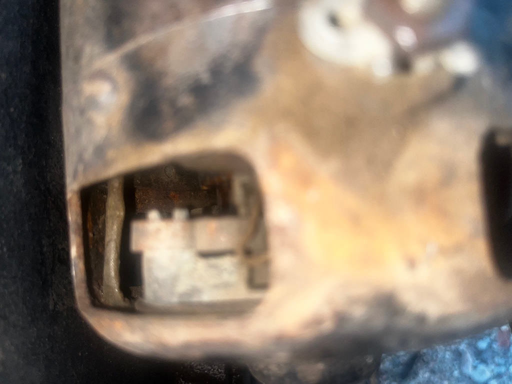

Thank you Jeff. I haven’t had much time to look at the generator this week but last night I pulled off the brush cover and then looked at the brushes and commutator and they look decent. It looks like they both could use a cleaning so I will do that today. Another thing I would like to point out is that the post that connects to the generator is kind of wobbly. Is that an issue?
Thanks, Jacob Mangold

The first thing I would is to clean up the armature. Besides that it’s time to rebuild your generator going by the looks of it. The loose post can’t be good in the long run. Do the simple things first and cleaning up the armature is one of them. It can look like it’s clean but a clean up with fine sandpaper will do wonders.

That rubber insulator at the generator post is probably just as old as the car, where it's dried out and is crumbly. You don't want to have that post ground out on the generator casing. Thinking that the post and the metal washers and the terminal nuts can be cleaned up and reused you can get the rubber insulator, along with the insulating gasket for the post, from Gaslight Auto parts in Ohio. ..... They also have replacement front and rear ball bearing assemblies that are lubricated for life...... .......... If you do change your mind about replacing parts in your generator be sure for total satisfaction if you do purchase a generator make sure it's a total rebuilt generator with new field coils, rewound armature assembly, rebuilt brush holder assembly, permanently lubricated ball bearings, .... Not just something that's been repainted and called rebuilt.

- Posts: 5141
Re: Generator Troubles
Low idle wont produce a net voltage gain over the battery voltage. Thats when you will see a positive amp reading. If you have a mechanical cutout it may not be closing until you reach a higher voltage generation above when it should. The generator, it self is fine.
AdminJeff
Jacob,
I concur w/ these folks, your generator is fine! Go driving!
Jeff
Jeff
