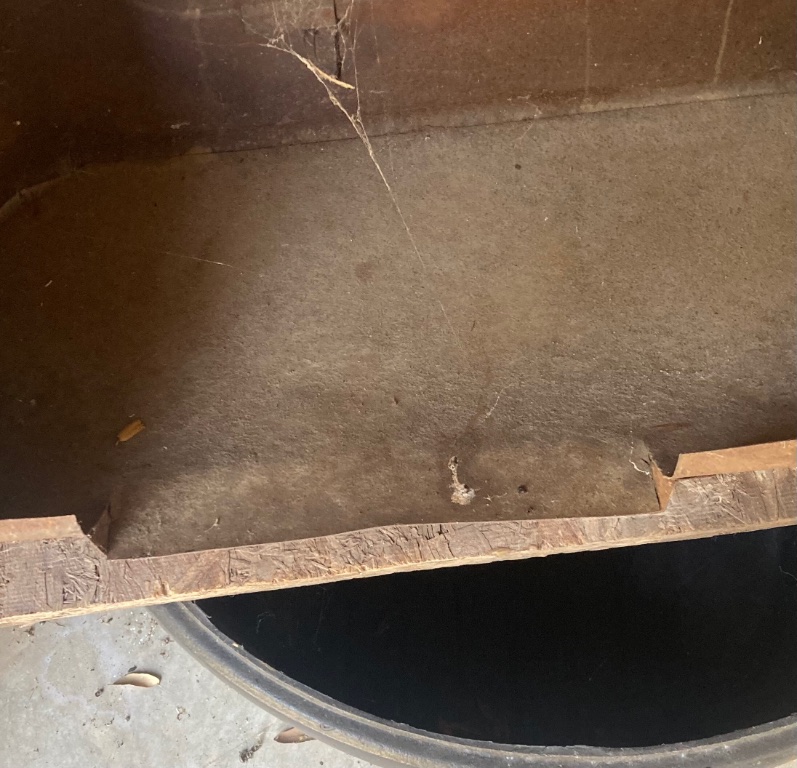

As promised, here are some pics of this ‘19-‘22 turtledeck wood frame. I thought it had a wood slat floor like my ‘14 but it doesn’t. First time I had it ‘on its nose’ and looked at the framing; it appears theres a part of the wood missing at the top of the pic. See the battery provision.

The turtle deck that George posted is exactly like the one I bought years ago for my 1919 Roadster. When I installed it I used the battery area for an idea where I should cut the wood floor and the overlaid sheet metal.

"As promised, here are some pics of this ‘19-‘22 turtledeck wood frame. I thought it had a wood slat floor like my ‘14 but it doesn’t. First time I had it ‘on its nose’ and looked at the framing; it appears theres a part of the wood missing at the top of the pic. See the battery provision."
Exactly what I am looking for. Could you possibly take measurements and draw the layout?

Chris,
Some people can draw measurements on photos; but I’m technologically challenged
. I hope this helps you. The hardwood boards are nailed from the bottom approx
2 1/2”- 2 3/4” apart. Mounting holes (4) for 3/8” carriage bolts extend thru rabbeted connections. More info ? Just ask…..

Absolutely Perfect. Thank You.George House wrote: ↑Wed Aug 09, 2023 9:49 amChris,
Some people can draw measurements on photos; but I’m technologically challenged. I hope this helps you. The hardwood boards are nailed from the bottom approx
