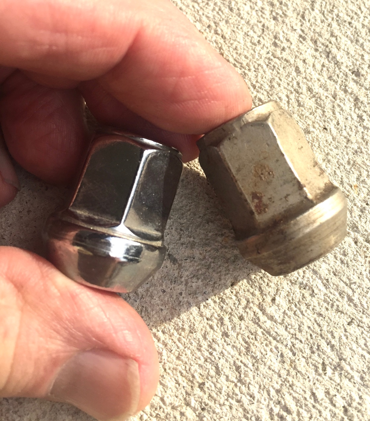

Post by DanTreace » Sun Aug 13, 2023 4:00 pm
Original on right, repro on left.

Post by TRDxB2 » Sun Aug 13, 2023 6:08 pm
Measure the depth of them to see if they are the same. The outside length isn't important. I have some original lug nuts and each incomplete set has one shorter than the other 8 - no idea why. For spare tire carrier?

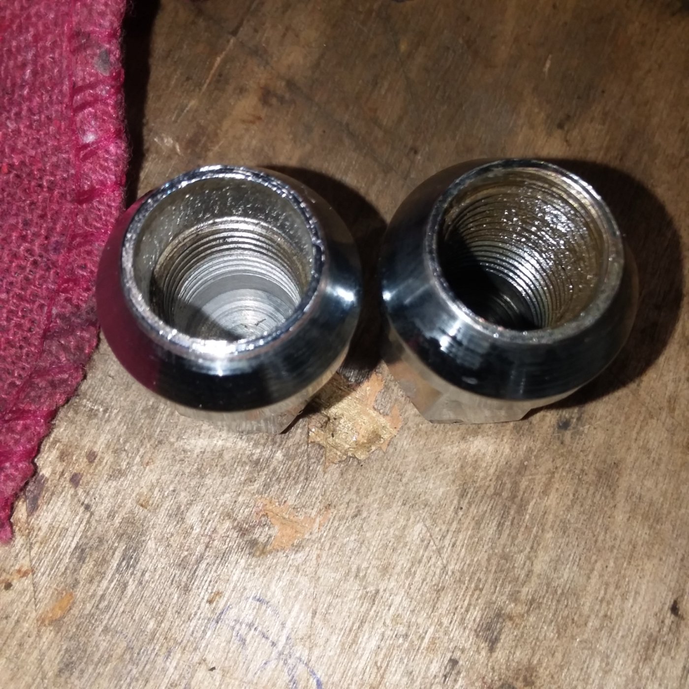

Both repro. Both failed to torque down.

Posts: 6581
Re: Repro LUG NUTS
Post by TRDxB2 » Sun Aug 13, 2023 11:01 pm
Professor Fate wrote:
Sun Aug 13, 2023 10:36 pm
Looks like the repro threads were expecting a longer stud bolt. The threads on the original look suspect. They don't look stripped just not able to do the job based on their condition

Re: Repro LUG NUTS
Post by Professor Fate » Mon Aug 14, 2023 2:07 am
You wrote...
".....The threads on the original look suspect."
Both lug nuts in the pic i posted are aftermarket reproduction. No original pictured. Pic shows
Inconsistent manufacturing and quality control on inferior product.

Post by Mark Gregush » Mon Aug 14, 2023 8:19 am
The Model A lug nut, the threaded area didn't start at the get-go. The opening at the bottom was little larger and clear of thread so it could clear the swedging where the lug bolt came through the drum/hub, but not as deep as shown in the first sample in photo directly above. The original Model T might have that same clear area.
What was found is some reproductions with thread the full length were fowling on the swedged area before fully seating so were not correctly holding the wheel.

Post by Professor Fate » Mon Aug 14, 2023 9:23 am
I cleaned a lot of debris from the lug nut off the threads of the stud.
