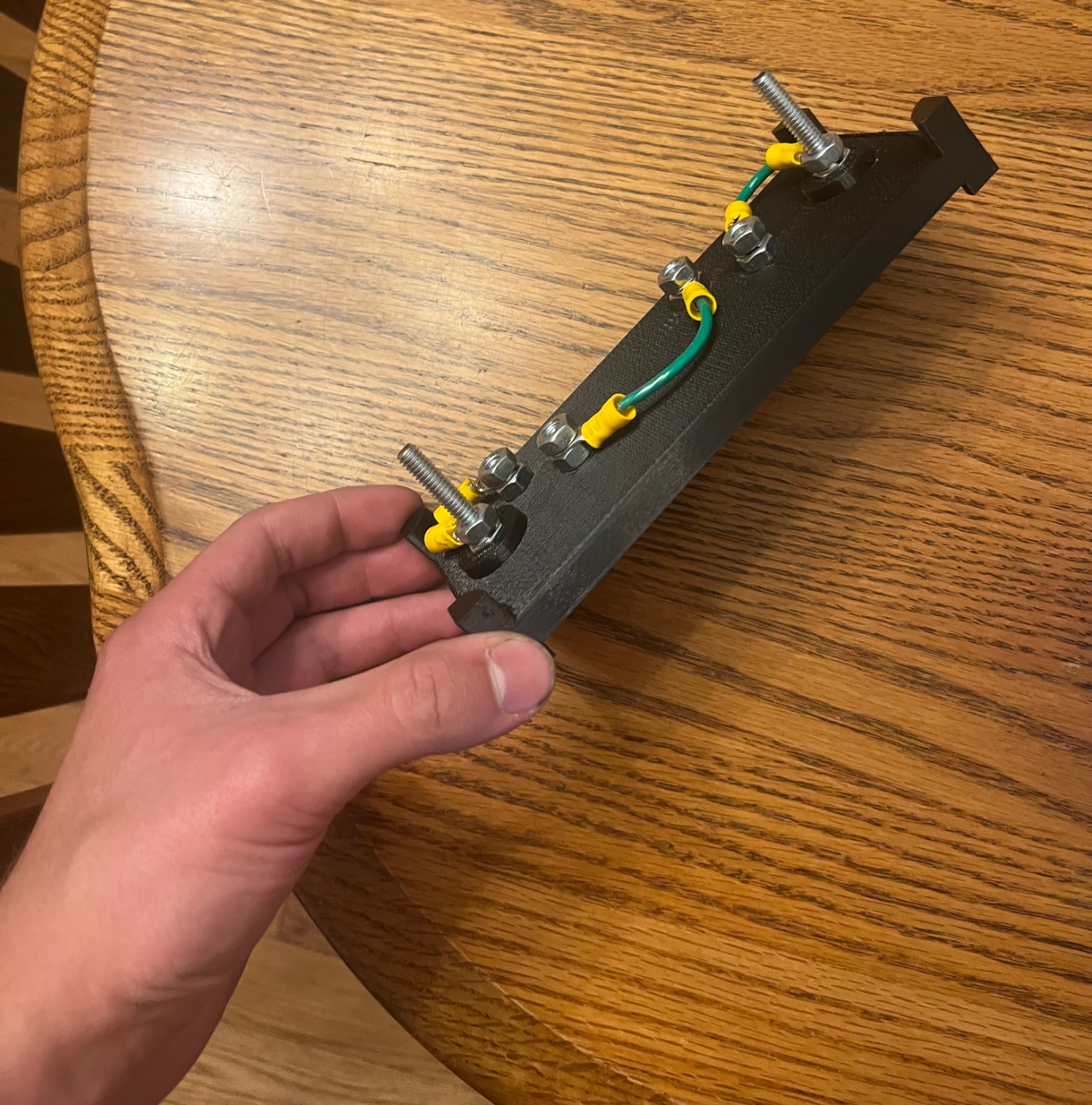

On that 6v dry cell topic I recently got a 1911 brush which needs 12v so I 3D printed what will be eventually the insert to a wooden box but it has contacts so that they can be in series. Im going to try and make the wood match the finish/ appearance of a coil box but my woodworking skills are iffy.

Nice setup. It looks like it fits in the box, hides the modern cells and makes all the connections. Your box will look great when it's done. Print is a neat approach.
