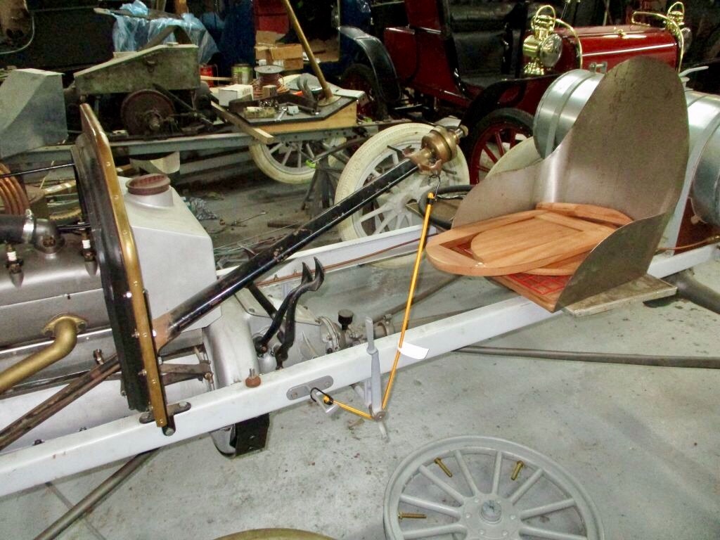

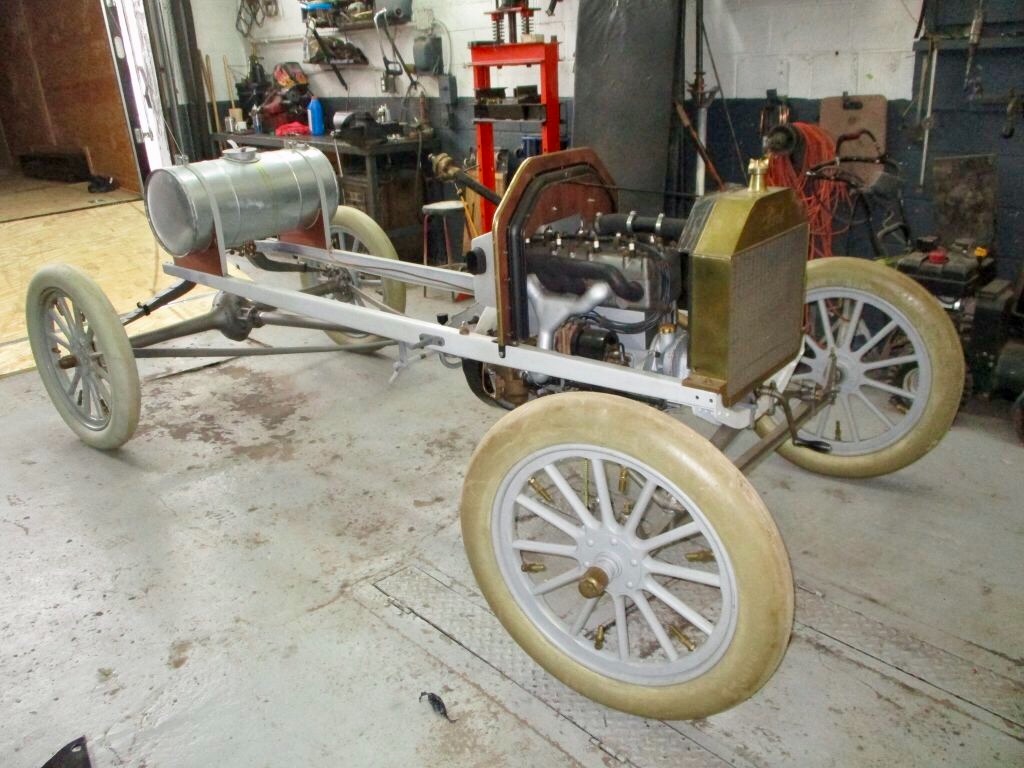

Just received these from Peter Fawcett's shop. They are beginning to fashion the seats, then putting together other remaining bits and pieces. Meanwhile, one of the Ford Special racers may have been sold by FMC back in 1912.

I've been trying to determine which of the Ford Special racers our motor "resided" in. I believe it's the same 300 cubic inch motor used in one of the two Fords that ran (and won) several races at the Mardi Gras Speed Carnival in New Orleans in late February 1911. It also may be the same one sold to Walker in 1912. Our motor was set up for no muffler, while the other Ford racers I've found pics of (4 or 5 of these machines existed) could be equipped with mufflers or side pipes. Because our motor was placed in a traditional Ford chassis, the fourth cylinder is actually behind the firewall, and so the exhaust manifold just has one large opening just behind the right side of the firewall. This photo shows what I believe is the same racer (engine), with a fake "tank" on the firewall hiding the 4th cylinder:
Initially the previous owners thought this motor was sold on one of The Henry Ford deacension sales held in the 1980's. However, some information obtained with the project indicates the motor was acquired by 1957, and I don't know that any FMC sales occurred prior to that (although they may have).
Much more to learn......

Very nice! Would love to see some detailed images of the engine, is there anything special about the drive train.
Thanks for posting
Thanks for posting

I wish Peter would show us step by step how he upholsters the seat. He does one super job
with fabric.
Thank you for the pictures Rob.
with fabric.
