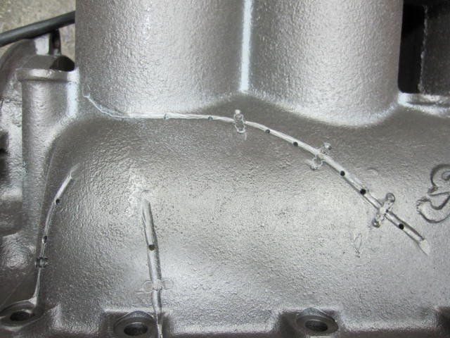

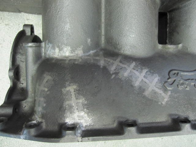

Problem is with any crack repair yo need to know how thick metal is as others have mentioned in the comments.
If you saw the video that someone posted ,it's a perfect example of HOW Not to Repair a block. "
These pictures represent a before and after of crack repair. The prior shop used JB weld the repair it ,that's why it's grooved out basically making casting weaker.
After thermally cleaning block all was exposed and we could see what they did wrong.
The parent material to be crack repaired has to be at least 3/16" thick for the pins to secure to.
if that isn't available we would cut the damaged area out and stitch a piece in.
The stitch pins have to intersect with each other so no gap is allowed, then there are locks that go across to keep it secure. As seen in the after picture above.
I would recommend that the block get cleaned and then magnafluxed "Crack checked" to make sure what you're looking at is the only one.
