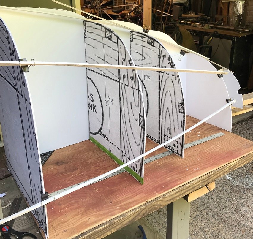

I thought I had seen some plans for the woodwork for a speedster body that would then be covered with aircraft type fabric. Does anyone know if those plans are still available?

I can't find my copy at the moment but the book "The Model T Ford in Speed & Sport" had discussion and plans for building a T speedster including those with fabric coverings. Some vendors have them and they can be found online. The plans were quite small and poor reproductions making them nice for concepts but severely lacking in detail. Might be a bit of a start anyway. When I built my speedster body, I started with a pretty complete chassis with engine and steering column and radiator so I could work out dimensions for reasonably comfortable seating with good access and reasonable steering wheel positioning. Having the radiator in place simplified defining the lines of body to establish the look you desire.

I have plans for the M&M speedster (Modern Mechanics Magazine) see my avatar the rear was fabric. --
I mocked up the plan to scale only to find out the side support widths were much to wide. But Its a good reference

Kurt has an interesting idea. I've wondered about using fabric to cover a speedster body. My airplane is steel tube with the shape produced by dacron fabric shrunk over a frame of wooden bulkheads (1/4 inch aircraft plywood) and spruce T-head stringers run longitudinally, glued at each bulkhead. The whole airplane only weighs around 800 lbs empty. You'd want to treat the fabric using one of the processes approved for aircraft. It has survived speeds far higher than a speedster would ever make.

My dad built a stick and cloth boat tail T speedster back about 30+ years ago. Was modeled closer to a 30’s British car tho. It held up really well, but was built upon a shortened TT frame. The stick and cloth portion of the car couldn’t have weighed more than 100 lbs

This speedster was made by a forum member many years back from muslin fabric and airplane dope.
