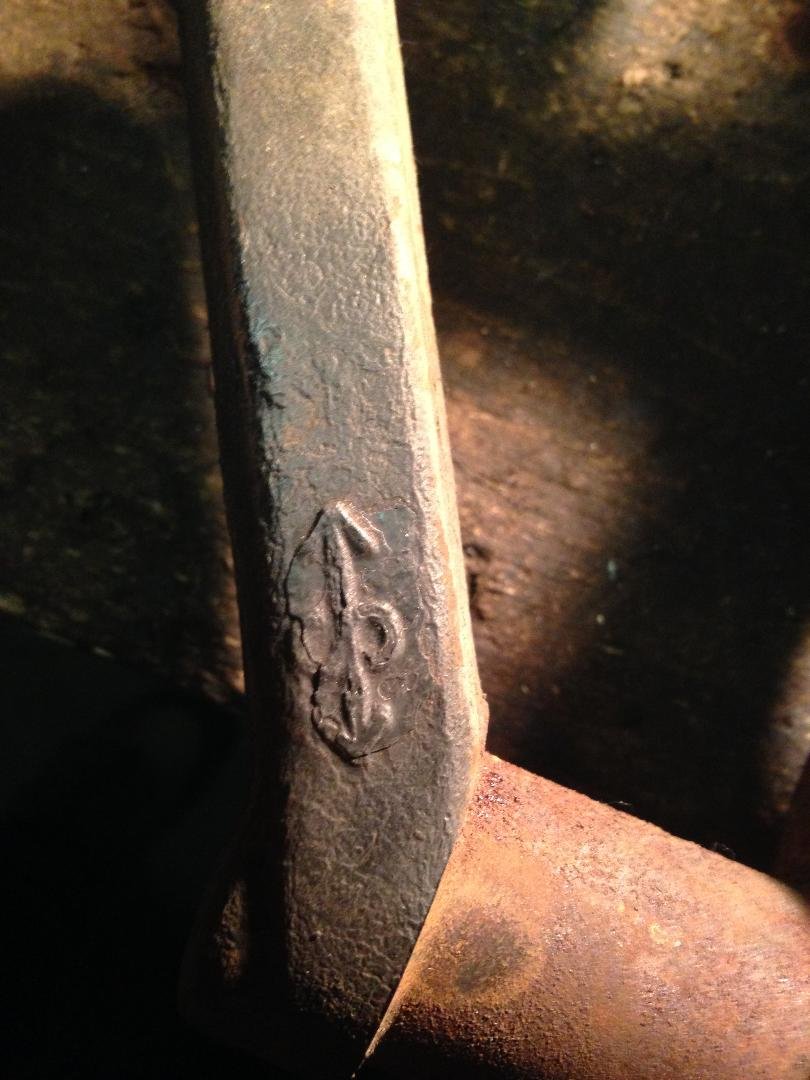

Hi,
Recently, dug this out of the shed.
Included are the markings on a counterbalance crankshaft. Does anyone have an idea who made this?
thanks
Kevin

Re: counterbalanced crankshaft what make??
Post by speedytinc » Mon Sep 25, 2023 12:39 pm
Shermike. They made 3 versions. Not enough seen to determine which one.

Sure break crank. Hang it on the wall.

I'm sure there is another SureBreak crank that has been running for nearly a hundred years BUT unfortunately one of our club members recently rebuilt his engine not knowing the reputation with a SureBreak crankshaft that had been checked out.
It broke in a very short time of driving! Was a sad learning experience that he didn't know before so he could have made an informed choice.

John, How can a person tell them apart? I have two, one in a running engine and a spare. I'd like to know if the spare is one of the better ones.

The difference is the size of the counter weights. I believe the "short" one shown is the best #3. #2 are a smaller dog bone shape. #1 has very little counter weight. This is from research basically looking @ aftermarket adds long ago.
