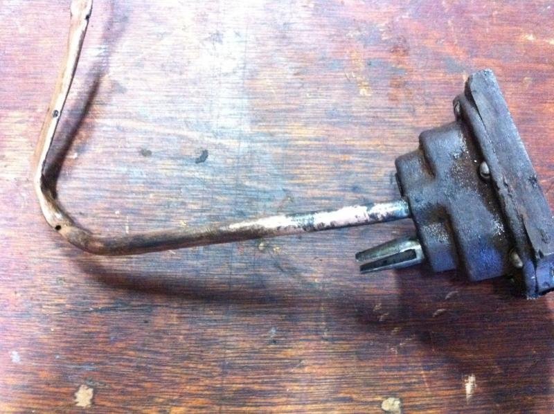

There is a dipper tray for the connecting rods, much like the Model A.
The connecting rod caps have cast in dippers.
There is a camshaft driven oil pump to fill that dipper tray.
