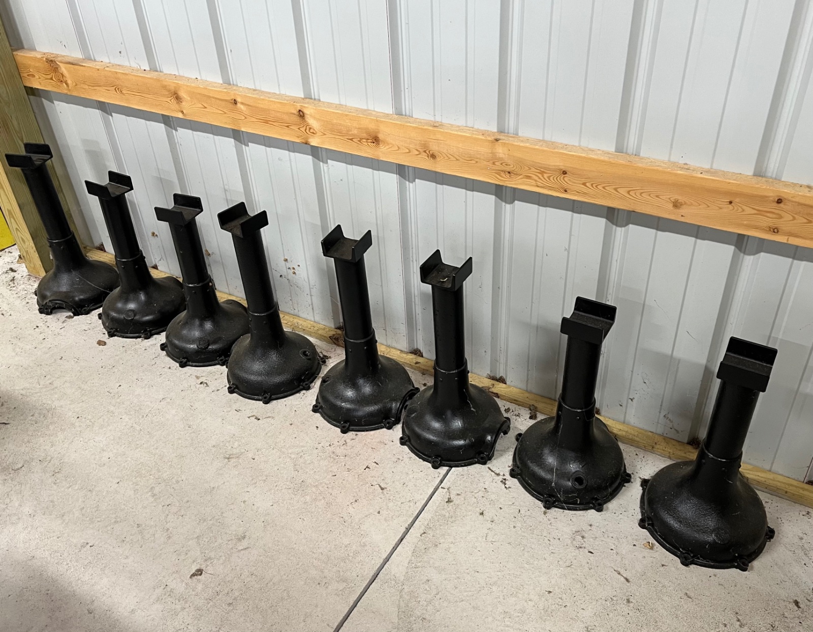

Post by Ed Fuller » Wed Sep 27, 2023 5:26 pm
I put my T’s on stands over the winter. These work well for me and it only takes a few minutes to jack up the car.
