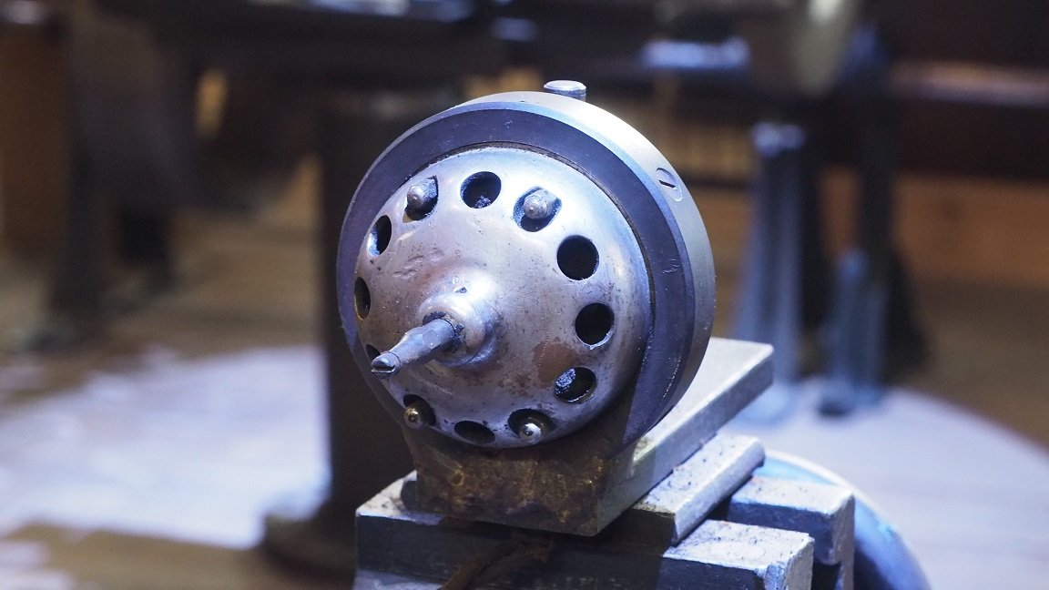

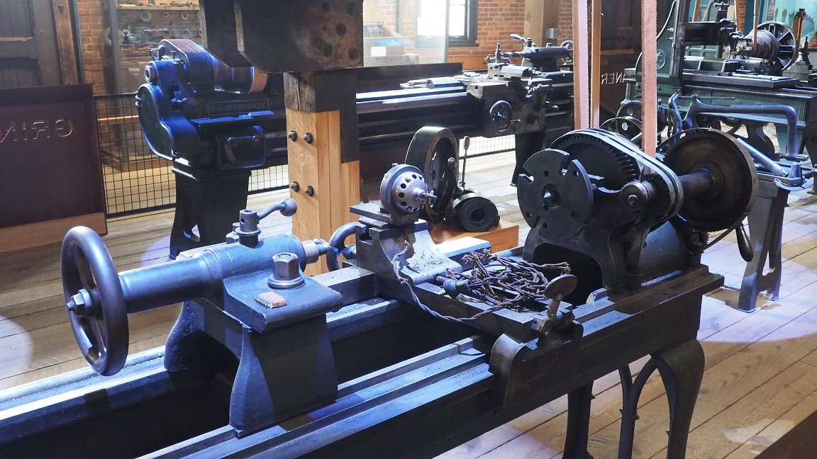

I saw this lathe post grinder in a museum last week and have a few questions I'm hoping someone can answer.
I'm not a machinist, so I was wondering what would the application be for a lathe post grinder with such a small diameter shank?

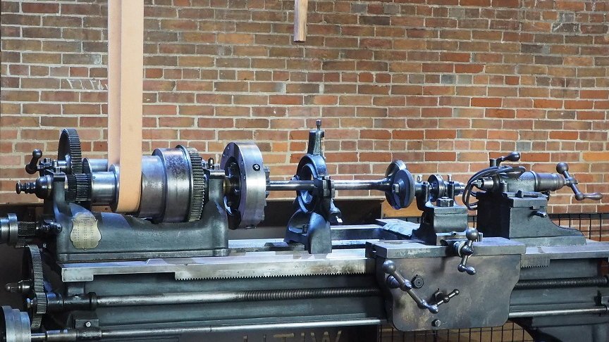

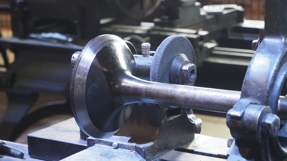

Also, is it oriented correctly for grinding/polishing? I was thinking the axis of the post grinder should be parallel to the lathe axis like the valve grinder in the last 2 pictures.

The shank appears to be missing a stone. The grinder can be turned and moved to different orientations relative to the work. That one may be suited for inside grinding.

Could be missing a cutter then it would used for cutting mica on armatures.  Jim

Could be missing a cutter then it would used for cutting mica on armatures. You might want to re-cord it before use.

As Tfan mentions, it's for undercutting mica in electric motor/generator armatures. It would have a tiny little saw blade in the end of its spindle.

That makes sense.
I was having a hard time picturing how that small diameter shaft and that tiny screw was going to hold a grinding stone.
It is positioned correctly for that application too.
Learned something new.

Hope this is OK Ken. I really like the shop you toured and your two pics of the HUGE engine valve in the lathe with another grinder are really neat!

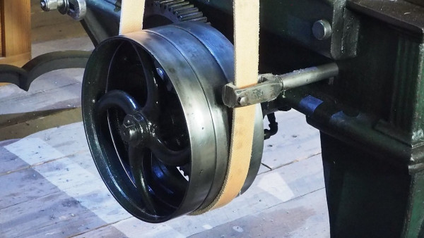

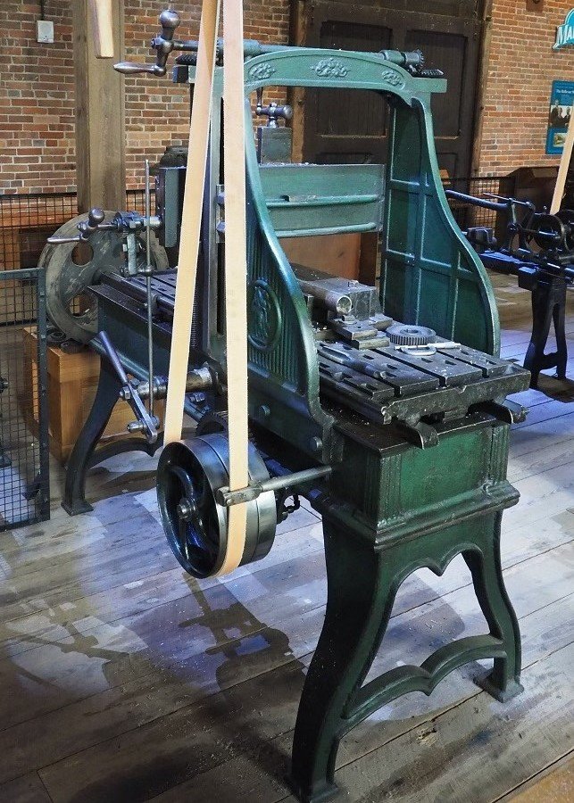

The other thing that caught my eye in the machine shop was the drums on the planer.
They reminded me of the drums in a model T transmission.
2 drums turn one way and the other 1 turns the other way.
The lever automatically slides the belt to the other drum at the end of the stroke.
This is the first planer that I have seen in a museum that was working.
The other ones I have seen were missing parts and hard to visualize exactly how it worked.
One last question, they refer to it as a planer.
Years ago, when I toured Giddings and Lewis, they called them shapers.
Is that like a soda vs pop thing?

That's a planer. Shapers are a little different.Ken Lefeber wrote: ↑Tue Sep 26, 2023 1:15 pmOne last question, they refer to it as a planer.
https://www.youtube.com/watch?v=7b81kWIhjPQ
Among other differences, a planer moves the workpiece under the cutter and a shaper moves the cutter over the workpiece.
