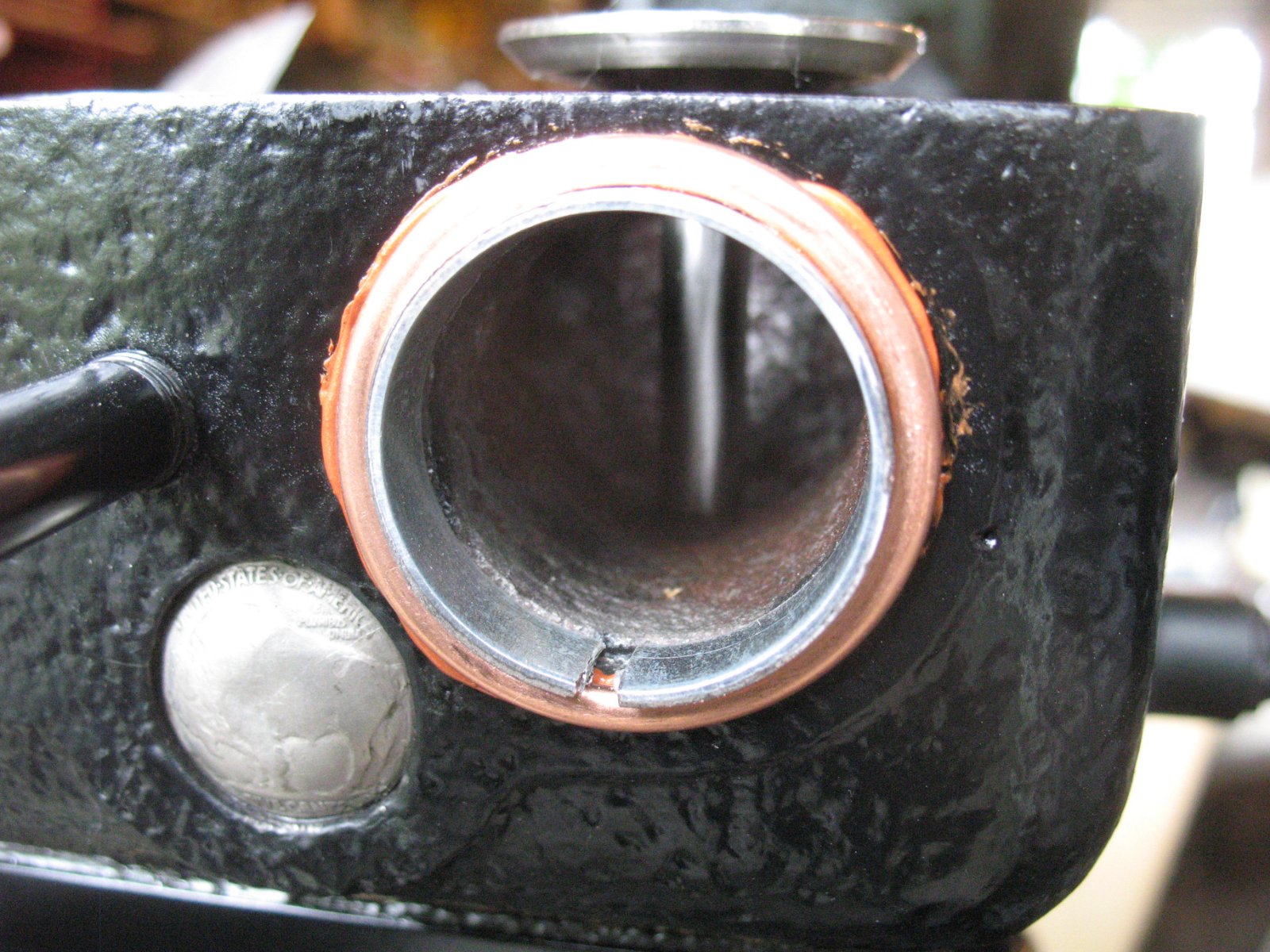

The stock gaskets and rings keep the exhaust manifold straight, as Larry says, and the last time I checked they were less than half the price of the copper one-piece gaskets.
If your block is pitted like this one you can add a little hi-temp RTV to help the gasket seal.
