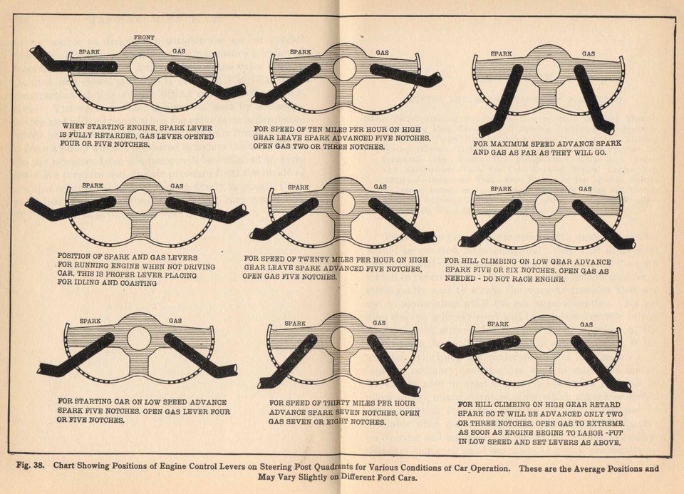

I'm pretty much repeating what was said earlier, but to keep it simple: Disconnect the wire from the magneto coil and check the voltage with the engine running. There's no reason why you can't use a digital meter, but be sure that it's set on AC. As was said earlier you should get at least 20 V with the engine running at a speed well above idle. If you do not, the issue is with the magneto; if you do, the problem is somewhere else.

John. Since Bill is new to Model T’s, what lever settings would you recommend to achieve “well above idle”, in order to attain 20 volts for the magneto test? Jim Patrick
