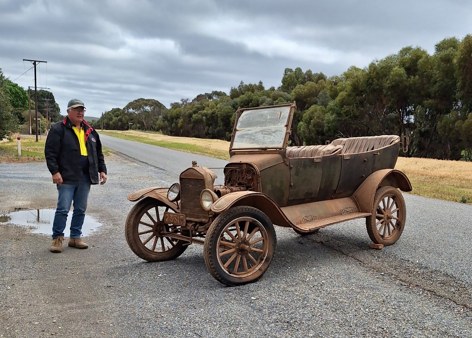

I brought this one home a few days ago.[attachment=0]20231005_105641.jpg[/attachment.
It is a 1922 Adelade built Duncan and Fraser tourer, standard except for full leather upholstery.
I have the job of assessing whether it is worth preserving as is, but making it safe to use. It will depend on how well the motor and trans perform, so the first task is to get it running . It is a fourth generation car to the family, so they would like to preserve it.
I took on the job when they gave me a realistic budget to work to.
I hope to report progress as we go.

I'd be willing to go to some expense to preserve the car as-is, or with some selective refurbishment, given the family history and the fact that so few original builds survive.

Very interesting barn find Allan. Yes, I’d attempt to preserve it too. Reinvigorate the dried out spokes. Lightly sand the rusty sheet metal and apply a satin preservative. Tell us more about those 2 interesting ‘scuff plates’ on the splash apron.

Looks like a good survivor. Get it to running, check out the transmission bands and try to get it to run. It looks like the wood structure might still be solid enough and stable but you’ll determine that as you get into it. Then there is the radiator and we hope it will still cool.
It’s good to see it’s pretty much kept inside and not left outside and that’s great.

I just noticed it has a wood firewall. I wonder if the steel firewall came out around the same time the American T’s did. Interesting.

Auxiliary belt driven magneto addition. ?

That is quite a beauty! Keep us posted in how the preservation goes.

Nice to see an original intact car in Oz Allan, not to many around at all.

The thing to remember with Australian bodied T's is they are all different for any year up to 1926, as all states had their own body builders, in fact there were two in my home state, South Australia.
Duncan Motors were the State distributors, selling their own Duncan and Fraser built cars. This style first cam out in 1919.
George, the scuff plates are D&F made brass cast accessory.
Duncan's had Line of accessories on offer. This car also came with a nickel plated radiator shell, headlight rims and windscreen pillars. It had a Corbin speedo. It has a steering column mounted pair of controls for an extra air intake on the intake manifold and a knob to adjust the mixture.
This car was painted dark green, including the fenders and running boards.
It has the original leather upholstery. I have never seen this before in a standard bodied car.
The magneto is a farm fit job. It is chain driven. There is no facility to adjust the timing, so it looks like they hand cranked it with the hood up, and reset the timing before driving off.
My son fitted a set of temporary plug wires to the magneto, we put fuel in the tank, made good the connections at the carburettor, and he cranked away. It sounded like it wanted to fire up. With a timing adjustment of the magneto, it went on the second pull. We had a mad scramble to shut it down again, as we had forgotten I had removed the starter motor!
Tomorrow night is the due start-up and run check. If all goes well, she will have new Kevlar bands while the firewall is off, and we can start on the refurbishment.

Just to keep it as is there will be some general expense that cannot be avoided for things such as new tires, new wiring, new battery, new top frame and top, new upholstery, new bands, new oil, new grease, new windshield (windscreen), radiator flush, coils cleaned and adjusted, carburetor rebuild w new gasket kit, gas tank and fuel system cleaned and flushed. The engine may be fine depending on its’ condition when last run. Instead of sanding the metal I would treat the rust with Ospho will halt the spread of the rust and convert the active rust into an inert and protective material. Sanding will take it down to the bare metal and destroy the patina, the uniform appearance and the original paint. Sand only if you intend to paint it. Jim Patrick
