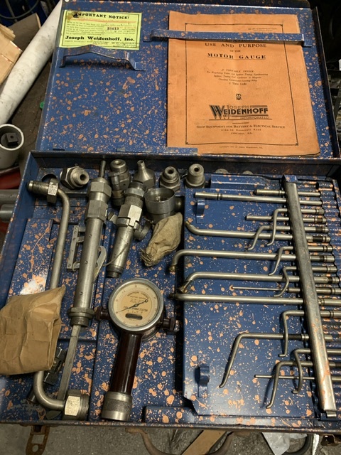

Here is how it was done back in day.
Here is manual
